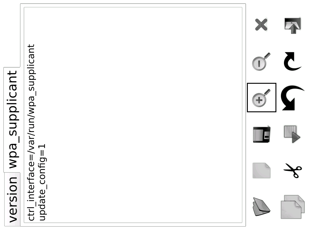

I can't get it working for me. I have a feeling I may have screwed up the scripts that run the chip inside. It's forgotten all my networks, won't find any networks when I do a scan, won't even tell me that it can't find any until I touch the screen or try to do something else (I let it sit for 5 minutes and it still said 'Scanning for networks...'), and won't do anything in third-party addons like KSM8 or vlasovsoft launcher.

I'm using someone else's screensaver mod, and it doesn't work with newer FWs. So currently, I'm using a Kobo Aura Edition 2 () running 4.2.8110. Attached any information I think might help. Let me know if you need anything else.
Nvm, I fixed it by reinstalling the firmware. But TY for your help!
