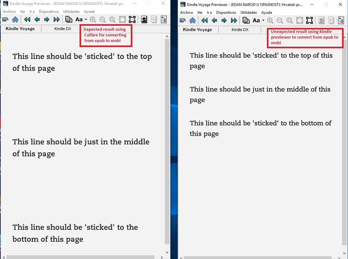

Hi all and thanks for reading this post.
I am trying to get help converting my epub file to .mobi using any oficcial Amazon tool (kindle previewer or kindlegen) as I contacted to KDP support unsuccessfully.
As you can see in the attachement I have 3 files:
1) Issue_test.epub that would be the original file that contains the html and css code
2) Issue_test_converted_by_calibre.mobi: This is a mobi file that preserver, exactly the format for the 3 pages that epub file contains.
As its name indicates, it was converted from attached epub file to .mobi using Calibre that is not an official tool to publish a .mobi in Amazon
3) Issue_test_converted_by_kindle_previewer.mobi: This is a mobi file that is not preserving the format for the 3 pages that epub file contains.
However, as you can see in the previous file, the .mobi file generated with a non oficcial tool is able to do it.
The problem is that I need to fix this issue if I want to publish a book with the same page format in Amazon .
How can I fix this issue? Could any one kindly provide an alternative html code that fixes the issue after kindle previewer conversion?
Thanks in advance!
Note: I also tried to use kindlegen directly to convert the epub file with the same unsuccessfully result.
I have included a comparative screen-shoot where you can see one example about the differences

Your CSS has problems. "width" is misspelled "widht". "vertical-align: center;" should be "vertical-align: middle;". Those should be corrected, but are not the cause of your problem.
Your use of the "height" property to control the height of table cells isn't recommended by Amazon. Amazon Kindle Publishing Guidelines version 2016.1, section 9.3.2 (Formatting Paragraphs): "The height property should only ever be applied to images in reflowable books."
It should work with newer devices, but older Kindles will display the book without your desired spacing. (If that matters to you.)
ETA: And if your book is converted to KFX format by Amazon, which is not under your control, it will automatically tighten up the vertical spacing. Trying to achieve a fixed layout in a reflowable book doesn't always work.

It is curious but I loaded the .mobi file converted using calibre in a old Kindle and one Kindle paperwhite and in both cases the result is exactly the same as the original epub. For this reason I wondering why KindleGen/Kindle Previewer is not able generate the same .mobi as calibre does because Kindle ebook devices can reproduce it as it is expected.
The conclusion is that Kindle Previewer is not converting in a good way :-(

A .mobi file produced by kindlegen contains both an old-style Mobipocket format supported by older kindle devices and a KF8 format with more advanced formatting options supported by newer devices.
According to the Mobipocket Reader documentation the "height" attribute is not allowed for table rows. Looking at the files you provided it appears that kindlegen has correctly stripped this out, but the calibre conversion has left it in.
The Kindle Previewer renders the height, making the calibre conversion look more like you desire. But an actual Kindle device may not perform the same way when given this incorrectly formatted MOBI file from calibre.
This is not related jut to Kindle Previewer. I loaded calibre converted .mobi in two Kindle devices (old one and paperwhite bought last year) and both devices rendered it as I expected and how it looks like on Kindle previewer.
Based in this testing, my conclusións are:
1) Calibre converts from epub to .mobi in a different way that Kindle previewer does
2) Kindle previewer applies a 'wrong' convert policy because they think that their devices can not render something that they can or maybe Kindle previewer has a 'bug'
From my point of view, there is just one solution.
1) Decompile .mobi file converted with Calibre, because I know that it really Works on Kindle devices.
2) Get the HTML/css code from this 'decompile' file
3) Try to apply this code to my epub
4) Convert this new epub versión using Kindle previewer and load the result.
If this Works ... voilà, we have the solution
If not ... there are no solution because Kindle previewer is the "guilty" of this bad conversión and you do not have an alternative if you want to publish in Amazon.
What do you think? Could any one help me to 'decompile' this .mobi file? I saw a couple of tolos in this fórum to do it but they are implemented in Phyton and it is a 'new world' for me
Thanks in advance!

Question:
You loaded your test MOBIs at Amazon, and downloaded the Preview mobis, to ensure that the results are what you expect--is that right?
Because what you see, prior to uploading the file(s) to the KDP cannot be relied upon, for something like this, as an accurate view. The KF7 supports for the table elements were very, very poor. And there are still millions of KF7 devices in the world.

I agree with what Hitch wrote. There have been more than a dozen e-ink Kindle models going back to 2007, each of which has multiple firmware versions that can be running on it. There is no way that you could have done enough testing to say that the calibre conversion works on all (or even most) "old" Kindle devices.
ETA: I think that you should learn to live with the fact that your exact desired formatting will not be present on every single kindle device. Even on devices where your formatting works it can be broken just by setting a very large font size.
The older kindle devices that can handle only the original MOBI format are a shrinking minority. As long as the formatting is good enough to be easily readable on those devices I don't see any compelling reason to put more effort into supporting them.
