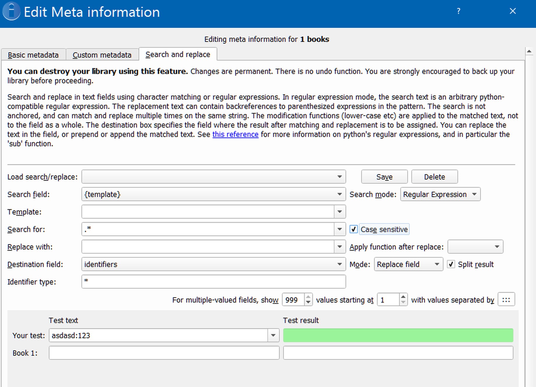

Use the following bulk metadata search/replace

Chaley, This works like a charm. So much easier!! Thank you very much.
@chaley - since I started using calibre, the bulk MDE Basic Tab has been incrementally enhanced with quite a few convenience options. Maybe a Remove all Identifiers option could be added too.
I have an S&R specification like yours saved as kill_idents, but I'd prefer an option in the General tab.
