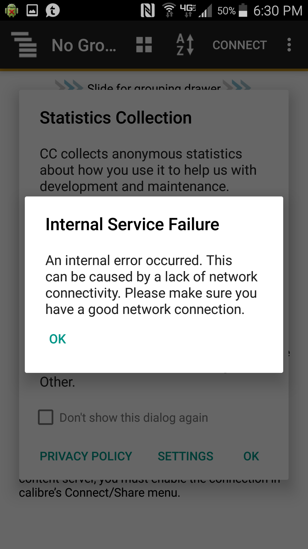

I am also having the same problem with cc purchased through Amazon. Since my phone updated to android 6, I have been unable to use cc. I receive the internal error and then another error that disappears quickly. I have been able to make screen captures of both errors. I have uninstalled and reinstalled many times. I get the same results each time. The second error says that I do not own the app.
James
jps1850 is offline   Reply With Quote

These are the screen captures. Hopefully I can get them to upload. I meant to have them with my prior message but they didn't go that time.
James

@jps1850: thanks. That tells me that Amazon's license check is failing. It isn't obvious how we can fix it.
Do either or both of you have the Google play store on your device. One thing I can look into is giving you a "promo code" for a GP copy of CC. Another thing I can check is making a new release for amazon to see if amazon has updated their license check.

I sent you a google play CC promotion code by private message. If you need some instructions on what to do with it, see Redeem a gift card or promotional code.

I uninstalled the Amazon copy and got the Google Play copy installed. It looks like everything is fine. I will be working with it in a few days. Thank You.
