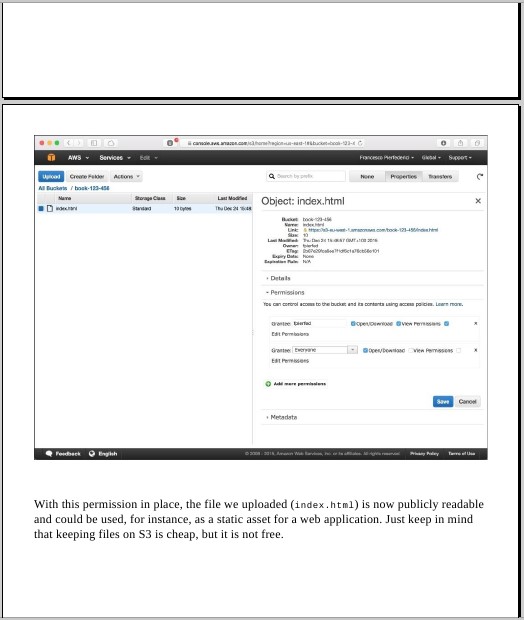

Hi Jellby! Your plugin is good, but I have problem with pictures after convert AZW3 in PDF. Converted PDF files have no full sizes of images (1st picture). Here how must to be correct (2nd picture).
How to fix this?

I can't say without seeing the code, it's probably something in how the size is specified.
How did you get the "correct" picture? If it's from a reader, it could be that the reader is forcing the image to fit in the page, regardless of the specified size...

I resolve this problem with next code (1st picture):
body {
prince-image-resolution: 166dpi;
hyphens: auto;
I have error message when want convert AZW3 file in PDF (2nd picture):
