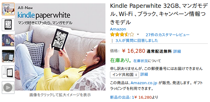

Originally Posted by zivilyn View Post
But I think most of KPW3 32GB version users are in Japan because of the E-comic demand.
There is a 32GB KPW3??
Yup, there is:
https://www.cnet.com/news/amazon-pre...ld-your-manga/
http://arstechnica.com/gadgets/2016/...ite-for-japan/
https://www.amazon.co.jp/dp/B01FIG3S..._i=pr-20161018
Black and White colors
Only around 15% costlier than PW3
