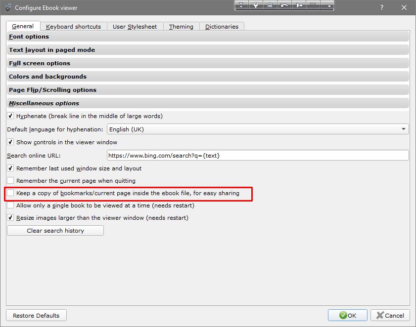

Is there/will there be a way to disable bookmarking?
There are very few changes to the db structure in 3.0 basically just the addition of a single table to store position data so you can sync your last read position across devices when using the in browser viewer. The addition of tables to a database is highly unlikey to cause any problems with anything.
I'm currently running Calibre 2.65. Is there/will there be a way to disable bookmarking? Will version 3 handle the bookmarking external to the ebook file? The reason I ask is that the calibre_bookmarks.txt file causes epubs to fail preflights when uploading to vendors and when sharing books from other calibre users, the ebooks open to their bookmarks. And all my bookmarking is handled my reading device.

@jvorzimmer - the current epub viewer can do what you appear to want, viz:
Click the gears icon in the viewer.
Attachment 152622
He is also talking about books from other users that already have the bookmarks in them. Btw calibre already updates the metadata and cover when sending book to device or saving to folder. Does it at the same time take out the bookmark file.
The bookmarks can be removed by the Modify ePub plugin, 2nd item in the Known Artefacts section.
No idea, I don't use them. Why don't you try it, if it doesn't then use Modify before send/save.
No it doesn't. As BR suggested, the Modify ePub before exporting the book for upload to the vendors is probably the way to go.
