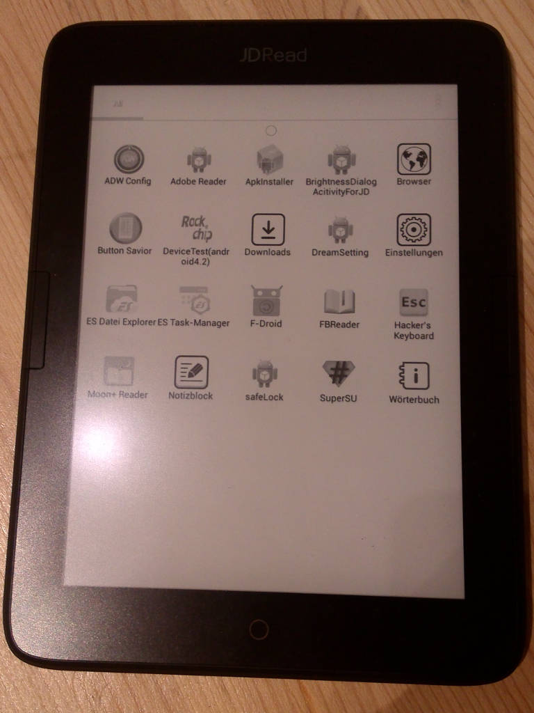

T63HD-JD for "Westerners"
Originally Posted by plus View Post
T63 is available, but only as a branded version. The T63HD-JD comes with a Chinese-only JD launcher app. No app-store, no adb, no language or timezone setting, no remount.
"Westerners" need to customize system.img to make it usable.
* Backup NAND and single parts using RkAndroidTool
count@address
0x00002000@0x00002000(misc)
0x00004000@0x00004000(kernel)
0x00008000@0x00008000(boot)
0x00010000@0x00010000(recovery)
0x00020000@0x00020000(backup)
0x00040000@0x00040000(cache)
0x00200000@0x00080000(userdata)
0x00002000@0x00280000(kpanic)
0x00100000@0x00282000(system)
* Install TWRP using RkAndroid Tool
* Install SuperSu using TWRP
* Alter build.prop:
ro.product.locale.language=en
ro.product.locale.region=GB
persist.sys.language=en
persist.sys.country=GB
persist.sys.timezone=Europe/Paris
persist.service.adb.enable=1
persist.service.debuggable=1
persist.sys.usb.config=mass_storage,adb
* Copy Settings*.apk, Settings*.odex, SystemUI.*, *IME*, HTML* from an Energy Sistem Pro HD Image's /system/app/ to yours
* Delete all fonts in /system/fonts/ and copy contents from Pro HD (Hyphenations)
* Same with dictionaries
* Install favourite launcher, RkApkinstaller and Button Savior, optional market, browser
* Factory reset
* Install reader app, filemanager, feedreader,... of choice
more or less...
Attachment 150123
Mine's in German language now.
I bought it for the hardware specs, 146 €. It feels solid, have no long-time experience yet.
Well, I made the mistake of buying a JRead (Boyue) T63. I see that you were able to customize it for "Westerners", but I cannot figure out how. Where do I even get the right RKAndroidTool? I assume I am supposed to use update-China-T63HD-JD-46.img. And then how do I get the build.prop and alter it accordingly? I have searched these forums looking for instructions I can follow, but was not successful finding them. (I would have been able to use adb, but as you suggest, this machine has been locked and so adb is not available.) If you (or anybody) can point me to instructions and the appropriate tools, I would really appreciate it.
qariwa55 is offline   Reply With Quote
