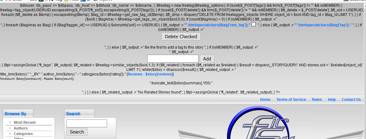

Ficsite.com
Is http://www.ficsite.com/ being considered for support?
MCBastos is offline   Reply With Quote
It's on the "Insufficient interest/updates" list.
Then, it had 508 stories and no updates in 6 months. Now it has 506 stories, most recent update appears to be July and it looks buggy (see attached).
I'll accept code if somebody else wants to write support for it, but I'm not interested in doing it. Sorry.
