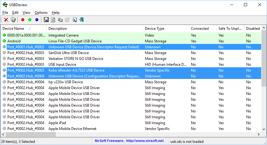

Hmmm... disconnect your Kobo form the computer, download and run Nirsoft's USBDeview. In USBDeview's display, select and remove any unconnected devices that you feel suspicious. Check the 3 devices selected in the attached image as a sample.

No new devices show up in USBDeview when plugging in the Kobo.
