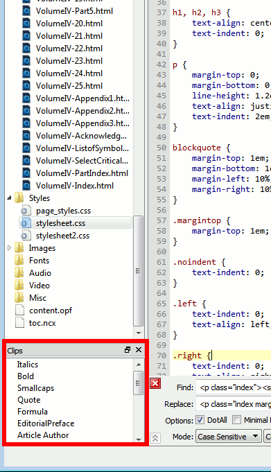

I attached my sigil_clips.ini in a ZIP file if that helps... although there aren't many clips beyond the defaults.
I also have the Clips window attached in the corner of my Sigil (which is how I can easily tell the Clips disappear into thin air when I open an EPUB).

I haven't used a fresh install of Sigil in a very long time, so I forget if that window exists by default.

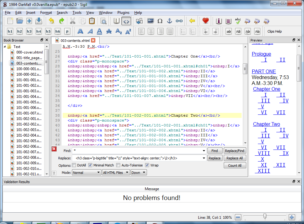

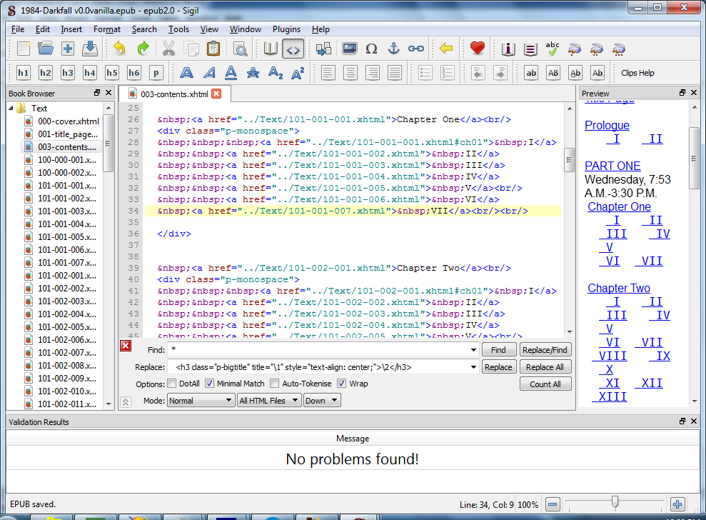

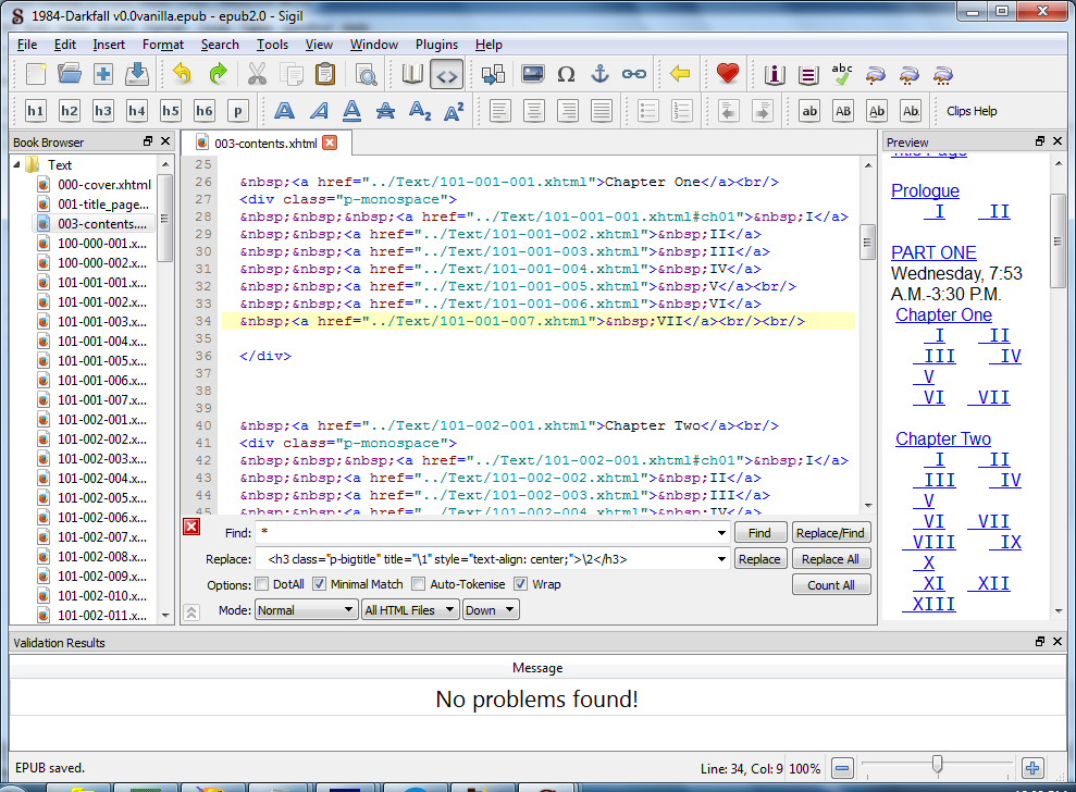

Yes, the CSS centering issue has been resolved and the fix will be in the next release. There's not however, going to be an intermediate/unofficial release that fixes only that issue. We are rapidly approaching the time for a 0.9.7 release, though, so hopefully it won't be too long of a wait.
I guess I better quit procrastinating, in that case. I have been formatting all my Dean Koontz books in "my preferred format," and I noticed one funny little thing occurring on a couple of books.
I have to preface this by saying, Dean Koontz structures his books differently nearly every time. Almost always he has "Part 1 (or I)" "Part 2 (or II)" etc.; and often he'll break those parts down into subsections. The particular books I've seen this anomaly on are those that have Roman Numeral sections, which I coped with by using a monospace font only on the sections within my Table of Contents.
The coding may well not be perfect; I'm a novice, as some of you know already. However, with some of the sections in the TOC, each time I do a save, Sigil adds one more blank line between the sections. I have included screenshots of the results of three saves. Because I tend to save at the slightest provocation, this has caused a rather large space between those sections, when I go back and look at it.
If the problem is because of something I have coded badly, I'd appreciate your feedback.
I'm also including the e-book itself, with the text stripped out so I don't step on anyone's copyright.
edit: book removed, apparently I didn't cut enough out of it to prevent problems with copyright. My bad.
It's not a life-changing problem, but I just thought you should know.
The blank line being added in Code View doesn't affect the rendering in Book View. It shouldn't really be happening, but I haven't had a chance to see WHY the line is being added each time (but I can replicate it). It's got something to do with the non-breaking space entity being used outside of a block-level element.
Yup, that cleared the problem up. I placed each of the sections within an unformatted <div>, and the problem disappeared. It's probably better discipline anyway, since there are the Part descriptions outside of a block-level element too.
Because it doesn't affect the book itself, I would think you'd put that on your priority list at "Well, everything else is perfect, I think I'll take a look at it now." :-)

<p>
<div> x</p>
</div>
You went to a lot of trouble to make a narrow TOC.
Then you have the 'PART <timestamp>' which made it wide.
Another <br /> needed?
<div>
  <a href="../Text/102-004-001.xhtml">PART TWO</a><br /> Wednesday, 5:30 P.M.-11:00 P.M.<br/>
</div>
