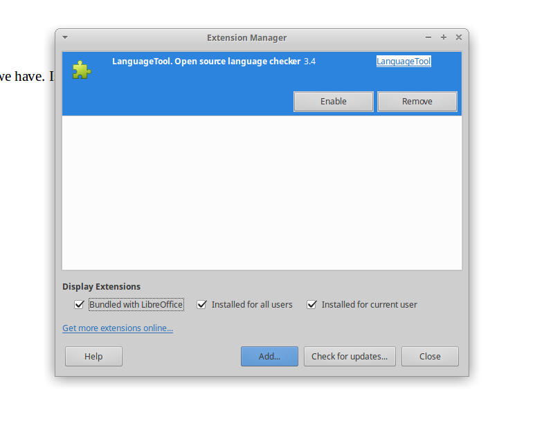

Thanks Doitsu. I tried to get it and ended up with the attachment.
I looked at the 'how to about installing' link on the download page but didn't really see a solution there for my problem. Was I missing something? (I'm on a Linux (Xubuntu) 64 bit computer.)

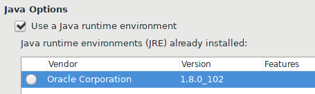

Thanks Doitsu. I appreciate the help. Unfortunately that JRE didn't appear in the list below. I waited 3 or 4 minutes. Here's the results from the terminal:
gregory@gregory-GA-A55M-DS2:~/Desktop$ java -version
The program 'java' can be found in the following packages:
 * default-jre
 * gcj-5-jre-headless
 * openjdk-8-jre-headless
 * gcj-4.8-jre-headless
 * gcj-4.9-jre-headless
 * openjdk-9-jre-headless
Try: sudo apt install <selected package>
To test whether a JRE is installed, open a terminal window and enter:
java -version
If you don't get a version number, you'll need to enter the following command to install a JRE:
sudo apt-get install default-jre

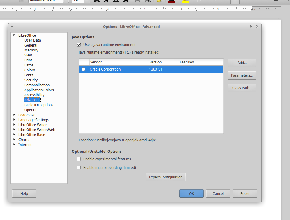

I didn't see anything that looked like a version number so I ran your command. It downloaded a lot.
gregory@gregory-GA-A55M-DS2:~/Desktop$ java -version The program 'java' can be found in the following packages: * default-jre * gcj-5-jre-headless * openjdk-8-jre-headless * gcj-4.8-jre-headless * gcj-4.9-jre-headless * openjdk-9-jre-headless Try: sudo apt install <selected package> gregory@gregory-GA-A55M-DS2:~/Desktop$ sudo apt-get install default-jre [sudo] password for gregory: Reading package lists... Done Building dependency tree Reading state information... Done The following packages were automatically installed and are no longer required: kde-l10n-engb linux-headers-4.4.0-21 linux-headers-4.4.0-21-generic linux-headers-4.4.0-28 linux-headers-4.4.0-28-generic linux-headers-4.4.0-31 linux-headers-4.4.0-31-generic linux-headers-4.4.0-34 linux-headers-4.4.0-34-generic linux-image-4.4.0-21-generic linux-image-4.4.0-28-generic linux-image-4.4.0-31-generic linux-image-4.4.0-34-generic linux-image-extra-4.4.0-21-generic linux-image-extra-4.4.0-28-generic linux-image-extra-4.4.0-31-generic linux-image-extra-4.4.0-34-generic Use 'sudo apt autoremove' to remove them. The following additional packages will be installed: ca-certificates-java default-jre-headless java-common openjdk-8-jre openjdk-8-jre-headless Suggested packages: default-java-plugin icedtea-8-plugin openjdk-8-jre-jamvm fonts-ipafont-gothic fonts-ipafont-mincho ttf-wqy-microhei | ttf-wqy-zenhei fonts-indic The following NEW packages will be installed: ca-certificates-java default-jre default-jre-headless java-common openjdk-8-jre openjdk-8-jre-headless 0 upgraded, 6 newly installed, 0 to remove and 98 not upgraded. Need to get 27.0 MB of archives. After this operation, 99.5 MB of additional disk space will be used. Do you want to continue? [Y/n] y Get:1 http://us.archive.ubuntu.com/ubuntu xenial/main amd64 java-common all 0.56ubuntu2 [7,742 B] Get:2 http://us.archive.ubuntu.com/ubuntu xenial/main amd64 default-jre-headless amd64 2:1.8-56ubuntu2 [4,380 B] Get:3 http://us.archive.ubuntu.com/ubuntu xenial/main amd64 ca-certificates-java all 20160321 [12.9 kB] Get:4 http://us.archive.ubuntu.com/ubuntu xenial-updates/main amd64 openjdk-8-jre-headless amd64 8u91-b14-3ubuntu1~16.04.1 [26.9 MB] Get:5 http://us.archive.ubuntu.com/ubuntu xenial-updates/main amd64 openjdk-8-jre amd64 8u91-b14-3ubuntu1~16.04.1 [69.6 kB] Get:6 http://us.archive.ubuntu.com/ubuntu xenial/main amd64 default-jre amd64 2:1.8-56ubuntu2 [980 B] Fetched 27.0 MB in 11s (2,309 kB/s) Selecting previously unselected package java-common. (Reading database ... 377429 files and directories currently installed.) Preparing to unpack .../java-common_0.56ubuntu2_all.deb ... Unpacking java-common (0.56ubuntu2) ... Selecting previously unselected package default-jre-headless. Preparing to unpack .../default-jre-headless_2%3a1.8-56ubuntu2_amd64.deb ... Unpacking default-jre-headless (2:1.8-56ubuntu2) ... Selecting previously unselected package ca-certificates-java. Preparing to unpack .../ca-certificates-java_20160321_all.deb ... Unpacking ca-certificates-java (20160321) ... Selecting previously unselected package openjdk-8-jre-headless:amd64. Preparing to unpack .../openjdk-8-jre-headless_8u91-b14-3ubuntu1~16.04.1_amd64.deb ... Unpacking openjdk-8-jre-headless:amd64 (8u91-b14-3ubuntu1~16.04.1) ... Selecting previously unselected package openjdk-8-jre:amd64. Preparing to unpack .../openjdk-8-jre_8u91-b14-3ubuntu1~16.04.1_amd64.deb ... Unpacking openjdk-8-jre:amd64 (8u91-b14-3ubuntu1~16.04.1) ... Selecting previously unselected package default-jre. Preparing to unpack .../default-jre_2%3a1.8-56ubuntu2_amd64.deb ... Unpacking default-jre (2:1.8-56ubuntu2) ... Processing triggers for man-db (2.7.5-1) ... Processing triggers for ca-certificates (20160104ubuntu1) ... Updating certificates in /etc/ssl/certs... 0 added, 0 removed; done. Running hooks in /etc/ca-certificates/update.d... Updating Mono key store Linux Cert Store Sync - version 4.2.1.0 Synchronize local certs with certs from local Linux trust store. Copyright 2002, 2003 Motus Technologies. Copyright 2004-2008 Novell. BSD licensed. I already trust 173, your new list has 173 Import process completed. Done done. Processing triggers for libc-bin (2.23-0ubuntu3) ... Processing triggers for gnome-menus (3.13.3-6ubuntu3.1) ... Processing triggers for desktop-file-utils (0.22-1ubuntu5) ... Processing triggers for mime-support (3.59ubuntu1) ... Processing triggers for hicolor-icon-theme (0.15-0ubuntu1) ... Setting up java-common (0.56ubuntu2) ... Setting up ca-certificates-java (20160321) ... Adding debian:CA_Disig_Root_R1.pem Adding debian:Comodo_Trusted_Services_root.pem Adding debian:ApplicationCA_-_Japanese_Government.pem Adding debian:UbuntuOne-Go_Daddy_Class_2_CA.pem Adding debian:Staat_der_Nederlanden_Root_CA_-_G2.pem Adding debian:Certification_Authority_of_WoSign_G2.pem Adding debian:TÜRKTRUST_Elektronik_Sertifika_Hizmet_Sağlayıcısı_H5.pem Adding debian:DST_ACES_CA_X6.pem Adding debian:Security_Communication_Root_CA.pem Adding debian:QuoVadis_Root_CA_3.pem Adding debian:RSA_Security_2048_v3.pem Adding debian:GeoTrust_Primary_Certification_Authority_-_G2.pem Adding debian:Certum_Trusted_Network_CA.pem Adding debian:AC_Raíz_Certicámara_S.A..pem Adding debian:QuoVadis_Root_CA_2_G3.pem Adding debian:Starfield_Services_Root_Certificate_Authority_-_G2.pem Adding debian:StartCom_Certification_Authority.pem Adding debian:Swisscom_Root_CA_1.pem Adding debian:Entrust_Root_Certification_Authority.pem Adding debian:IdenTrust_Commercial_Root_CA_1.pem Adding debian:CNNIC_ROOT.pem Adding debian:GlobalSign_ECC_Root_CA_-_R4.pem Adding debian:GeoTrust_Universal_CA.pem Adding debian:AffirmTrust_Premium.pem Adding debian:Sonera_Class_2_Root_CA.pem Adding debian:Security_Communication_RootCA2.pem Adding debian:DigiCert_Global_Root_G2.pem Adding debian:Root_CA_Generalitat_Valenciana.pem Adding debian:Atos_TrustedRoot_2011.pem Adding debian:StartCom_Certification_Authority_2.pem Adding debian:certSIGN_ROOT_CA.pem Adding debian:Verisign_Class_1_Public_Primary_Certification_Authority_-_G3.pem Adding debian:GlobalSign_Root_CA.pem Adding debian:DigiCert_Global_Root_CA.pem Adding debian:COMODO_RSA_Certification_Authority.pem Adding debian:Equifax_Secure_CA.pem Adding debian:Verisign_Class_3_Public_Primary_Certification_Authority_2.pem Adding debian:TURKTRUST_Certificate_Services_Provider_Root_2007.pem Adding debian:Buypass_Class_3_Root_CA.pem Adding debian:OISTE_WISeKey_Global_Root_GA_CA.pem Adding debian:Visa_eCommerce_Root.pem Adding debian:TWCA_Root_Certification_Authority.pem Adding debian:Deutsche_Telekom_Root_CA_2.pem Adding debian:Verisign_Class_1_Public_Primary_Certification_Authority.pem Adding debian:UbuntuOne-ValiCert_Class_2_VA.pem Adding debian:Network_Solutions_Certificate_Authority.pem Adding debian:Chambers_of_Commerce_Root_-_2008.pem Adding debian:Camerfirma_Global_Chambersign_Root.pem Adding debian:Swisscom_Root_CA_2.pem Adding debian:TeliaSonera_Root_CA_v1.pem Adding debian:Equifax_Secure_eBusiness_CA_1.pem Adding debian:Sonera_Class_1_Root_CA.pem Adding debian:TWCA_Global_Root_CA.pem Adding debian:OISTE_WISeKey_Global_Root_GB_CA.pem Adding debian:S-TRUST_Universal_Root_CA.pem Adding debian:China_Internet_Network_Information_Center_EV_Certificates_Root.pem Adding debian:SecureTrust_CA.pem Adding debian:CFCA_EV_ROOT.pem Adding debian:Entrust.net_Premium_2048_Secure_Server_CA.pem Adding debian:Trustis_FPS_Root_CA.pem Adding debian:E-Tugra_Certification_Authority.pem Adding debian:CA_Disig.pem Adding debian:UbuntuOne-Go_Daddy_CA.pem Adding debian:Camerfirma_Chambers_of_Commerce_Root.pem Adding debian:Certplus_Class_2_Primary_CA.pem Adding debian:DST_Root_CA_X3.pem Adding debian:Hongkong_Post_Root_CA_1.pem Adding debian:thawte_Primary_Root_CA_-_G2.pem Adding debian:AddTrust_Low-Value_Services_Root.pem Adding debian:GeoTrust_Universal_CA_2.pem Adding debian:thawte_Primary_Root_CA_-_G3.pem Adding debian:Starfield_Class_2_CA.pem Adding debian:SecureSign_RootCA11.pem Adding debian:Secure_Global_CA.pem Adding debian:VeriSign_Class_3_Public_Primary_Certification_Authority_-_G4.pem Adding debian:Taiwan_GRCA.pem Adding debian:Actalis_Authentication_Root_CA.pem Adding debian:NetLock_Qualified_=Class_QA=_Root.pem Adding debian:TÜBİTAK_UEKAE_Kök_Sertifika_Hizmet_Sağlayıcısı_-_Sürüm_3.pem Adding debian:Microsec_e-Szigno_Root_CA.pem Adding debian:Buypass_Class_2_CA_1.pem Adding debian:ComSign_CA.pem Adding debian:DigiCert_Trusted_Root_G4.pem Adding debian:CA_WoSign_ECC_Root.pem Adding debian:USERTrust_ECC_Certification_Authority.pem Adding debian:TC_TrustCenter_Class_3_CA_II.pem Adding debian:Comodo_Secure_Services_root.pem Adding debian:Go_Daddy_Root_Certificate_Authority_-_G2.pem Adding debian:UTN_USERFirst_Email_Root_CA.pem Adding debian:Baltimore_CyberTrust_Root.pem Adding debian:Verisign_Class_3_Public_Primary_Certification_Authority_-_G3.pem Adding debian:VeriSign_Universal_Root_Certification_Authority.pem Adding debian:COMODO_ECC_Certification_Authority.pem Adding debian:AddTrust_Qualified_Certificates_Root.pem Adding debian:Comodo_AAA_Services_root.pem Adding debian:DigiCert_Assured_ID_Root_G3.pem Adding debian:GeoTrust_Primary_Certification_Authority_-_G3.pem Adding debian:GlobalSign_ECC_Root_CA_-_R5.pem Adding debian:WoSign_China.pem Adding debian:AffirmTrust_Networking.pem Adding debian:Izenpe.com.pem Adding debian:NetLock_Express_=Class_C=_Root.pem Adding debian:AffirmTrust_Premium_ECC.pem Adding debian:Verisign_Class_3_Public_Primary_Certification_Authority_-_G2.pem Adding debian:EC-ACC.pem Adding debian:AddTrust_Public_Services_Root.pem Adding debian:Cybertrust_Global_Root.pem Adding debian:Staat_der_Nederlanden_EV_Root_CA.pem Adding debian:T-TeleSec_GlobalRoot_Class_2.pem Adding debian:Microsec_e-Szigno_Root_CA_2009.pem Adding debian:UTN_USERFirst_Hardware_Root_CA.pem Adding debian:NetLock_Arany_=Class_Gold=_Főtanúsítvány.pem Adding debian:NetLock_Business_=Class_B=_Root.pem Adding debian:Hellenic_Academic_and_Research_Institutions_RootCA_2011.pem Adding debian:Buypass_Class_2_Root_CA.pem Adding debian:AddTrust_External_Root.pem Adding debian:ePKI_Root_Certification_Authority.pem Adding debian:SwissSign_Platinum_CA_-_G2.pem Adding debian:DigiCert_Assured_ID_Root_CA.pem Adding debian:ACCVRAIZ1.pem Adding debian:Certinomis_-_Autorité_Racine.pem Adding debian:Juur-SK.pem Adding debian:QuoVadis_Root_CA.pem Adding debian:XRamp_Global_CA_Root.pem Adding debian:Entrust_Root_Certification_Authority_-_EC1.pem Adding debian:D-TRUST_Root_Class_3_CA_2_2009.pem Adding debian:T-TeleSec_GlobalRoot_Class_3.pem Adding debian:S-TRUST_Authentication_and_Encryption_Root_CA_2005_PN.pem Adding debian:CA_Disig_Root_R2.pem Adding debian:Starfield_Root_Certificate_Authority_-_G2.pem Adding debian:USERTrust_RSA_Certification_Authority.pem Adding debian:WellsSecure_Public_Root_Certificate_Authority.pem Adding debian:GeoTrust_Global_CA.pem Adding debian:StartCom_Certification_Authority_G2.pem Adding debian:Verisign_Class_1_Public_Primary_Certification_Authority_-_G2.pem Adding debian:Certigna.pem Adding debian:GlobalSign_Root_CA_-_R3.pem Adding debian:PSCProcert.pem Adding debian:SwissSign_Silver_CA_-_G2.pem Adding debian:IGC_A.pem Adding debian:Security_Communication_EV_RootCA1.pem Adding debian:COMODO_Certification_Authority.pem Adding debian:Verisign_Class_2_Public_Primary_Certification_Authority_-_G2.pem Adding debian:Go_Daddy_Class_2_CA.pem Adding debian:thawte_Primary_Root_CA.pem Adding debian:Verisign_Class_2_Public_Primary_Certification_Authority_-_G3.pem Adding debian:Verisign_Class_3_Public_Primary_Certification_Authority.pem Adding debian:Autoridad_de_Certificacion_Firmaprofesional_CIF_A62634068.pem Adding debian:Entrust_Root_Certification_Authority_-_G2.pem Adding debian:Equifax_Secure_Global_eBusiness_CA.pem Adding debian:Staat_der_Nederlanden_Root_CA.pem Adding debian:ssl-cert-snakeoil.pem Adding debian:SwissSign_Gold_CA_-_G2.pem Adding debian:Global_Chambersign_Root_-_2008.pem Adding debian:TÜRKTRUST_Elektronik_Sertifika_Hizmet_Sağlayıcısı_H6.pem Adding debian:QuoVadis_Root_CA_1_G3.pem Adding debian:IdenTrust_Public_Sector_Root_CA_1.pem Adding debian:GeoTrust_Primary_Certification_Authority.pem Adding debian:Certum_Root_CA.pem Adding debian:EBG_Elektronik_Sertifika_Hizmet_Sağlayıcısı.pem Adding debian:DigiCert_High_Assurance_EV_Root_CA.pem Adding debian:DigiCert_Global_Root_G3.pem Adding debian:EE_Certification_Centre_Root_CA.pem Adding debian:QuoVadis_Root_CA_3_G3.pem Adding debian:D-TRUST_Root_Class_3_CA_2_EV_2009.pem Adding debian:NetLock_Notary_=Class_A=_Root.pem Adding debian:Swisscom_Root_EV_CA_2.pem Adding debian:WoSign.pem Adding debian:QuoVadis_Root_CA_2.pem Adding debian:Certinomis_-_Root_CA.pem Adding debian:GeoTrust_Global_CA_2.pem Adding debian:GlobalSign_Root_CA_-_R2.pem Adding debian:ACEDICOM_Root.pem Adding debian:Staat_der_Nederlanden_Root_CA_-_G3.pem Adding debian:AffirmTrust_Commercial.pem Adding debian:DigiCert_Assured_ID_Root_G2.pem Adding debian:VeriSign_Class_3_Public_Primary_Certification_Authority_-_G5.pem done. Processing triggers for ca-certificates (20160104ubuntu1) ... Updating certificates in /etc/ssl/certs... 0 added, 0 removed; done. Running hooks in /etc/ca-certificates/update.d... done. Updating Mono key store Linux Cert Store Sync - version 4.2.1.0 Synchronize local certs with certs from local Linux trust store. Copyright 2002, 2003 Motus Technologies. Copyright 2004-2008 Novell. BSD licensed. I already trust 173, your new list has 173 Import process completed. Done done. Setting up openjdk-8-jre-headless:amd64 (8u91-b14-3ubuntu1~16.04.1) ... update-alternatives: using /usr/lib/jvm/java-8-openjdk-amd64/jre/bin/rmid to provide /usr/bin/rmid (rmid) in auto mode update-alternatives: using /usr/lib/jvm/java-8-openjdk-amd64/jre/bin/java to provide /usr/bin/java (java) in auto mode update-alternatives: using /usr/lib/jvm/java-8-openjdk-amd64/jre/bin/keytool to provide /usr/bin/keytool (keytool) in auto mode update-alternatives: using /usr/lib/jvm/java-8-openjdk-amd64/jre/bin/jjs to provide /usr/bin/jjs (jjs) in auto mode update-alternatives: using /usr/lib/jvm/java-8-openjdk-amd64/jre/bin/pack200 to provide /usr/bin/pack200 (pack200) in auto mode update-alternatives: using /usr/lib/jvm/java-8-openjdk-amd64/jre/bin/rmiregistry to provide /usr/bin/rmiregistry (rmiregistry) in auto mode update-alternatives: using /usr/lib/jvm/java-8-openjdk-amd64/jre/bin/unpack200 to provide /usr/bin/unpack200 (unpack200) in auto mode update-alternatives: using /usr/lib/jvm/java-8-openjdk-amd64/jre/bin/orbd to provide /usr/bin/orbd (orbd) in auto mode update-alternatives: using /usr/lib/jvm/java-8-openjdk-amd64/jre/bin/servertool to provide /usr/bin/servertool (servertool) in auto mode update-alternatives: using /usr/lib/jvm/java-8-openjdk-amd64/jre/bin/tnameserv to provide /usr/bin/tnameserv (tnameserv) in auto mode update-alternatives: using /usr/lib/jvm/java-8-openjdk-amd64/jre/lib/jexec to provide /usr/bin/jexec (jexec) in auto mode Setting up default-jre-headless (2:1.8-56ubuntu2) ... Setting up openjdk-8-jre:amd64 (8u91-b14-3ubuntu1~16.04.1) ... update-alternatives: using /usr/lib/jvm/java-8-openjdk-amd64/jre/bin/policytool to provide /usr/bin/policytool (policytool) in auto mode Setting up default-jre (2:1.8-56ubuntu2) ... Processing triggers for libc-bin (2.23-0ubuntu3) ... gregory@gregory-GA-A55M-DS2:~/Desktop$
Okay, now I have the Oracle corp. (see screenshot)
I tried LO and didn't notice a grammar checker so I went to the Extensions Manager and there it was so I enabled it, but then I got this window (160). I clicked Okay. When I did, the window popped up twice more and I clicked okay twice more. Which brought me back to the Extension Manager (161) and when I clicked "Enable" I just got the same error as previously.
If you're not comfortable using the terminal, you could also install Java with Ubuntu Software Center or Synaptic, if it's installed. (Search for java-common.)
After the JRE installation you'll need to check the “Use a Java runtime environment” in LibreOffice.
Yeah, I checked and it was checked.

It looks like the Java installation worked and LanguageTool should work, too.
Please check the LibreOffice version number (Help->About). If it starts with a 4.x, you have an older version that might not work with LanguageTool.

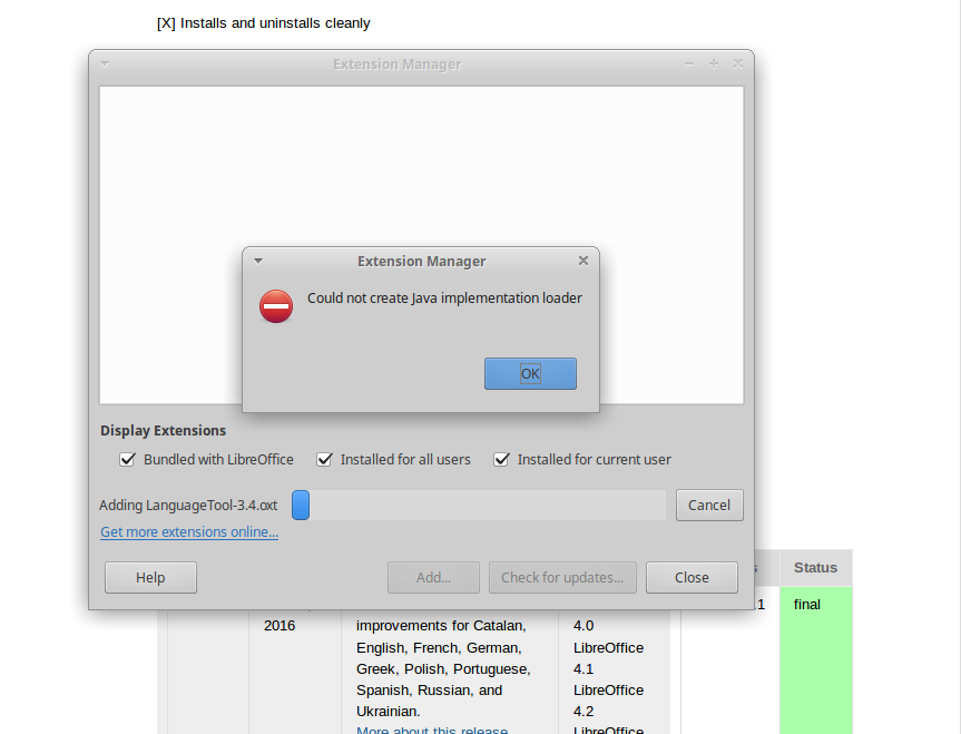

Yeah yeah, I'll definitely try your plug-in. Thanks. As to the Libre Office, I'm not on that computer now but I'm quite sure it has the same version of LO as this one, which is 5.142.

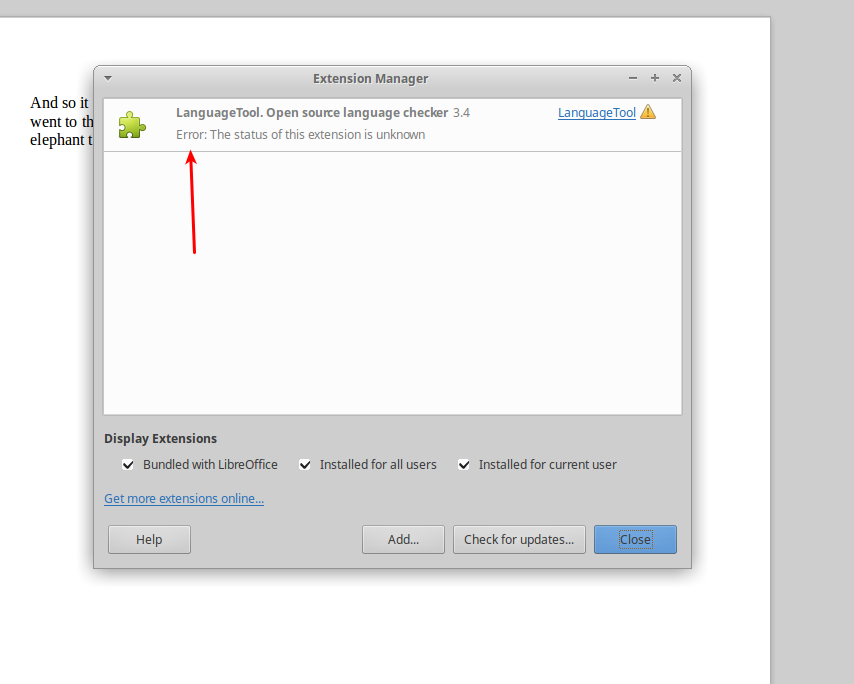

Interestingly, I had the 3.4 oxt extension on this computer's LO but there was no grammar checking. So I overwrited the 3.4 with the 3.5 and then it said I had no Java.
I'll check on that other computer again as soon as I can. (That's the computer I really want it on.)
This is kind of tanatalizing me because I really really like the Language Tool online checker. It would be so nice to have it as part of LO.
Since LanguageTool requires Java and you didn't have Java installed it couldn't work.
If you installed the 3.4 oxt extension on your other machine, too, installing Java and checking “Use a Java runtime environment” should make it work. (You'll also have to restart LibreOffice.)
Simply overwriting the 3.4 oxt extension doesn't work. You'll have to uninstall older versions via Tools→Plugin Manager.
You might want to completely uninstall and reinstall LibreOffice and LanguageTool. (If the installation succeeds you should see a LanguageTool menu item in the Tools menu.)

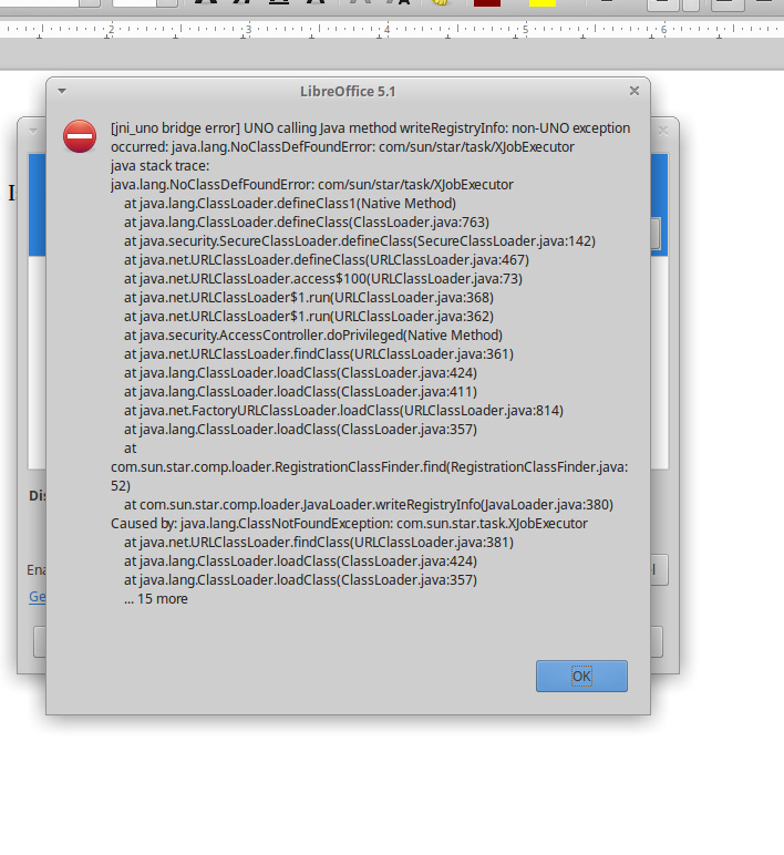

I have that Language Tool in the Tools menu (on my home computer, which I'm on now). It checks nothing as I type (and I have the option set for it to do so) and when I do the check and recheck from the dropdown it also does nothing. I looked at the extension manager and found that there was an issue (screenshot) with the .oxt so maybe that was the problem.
Anyway, I'm making this seem whipsawed, where it's hard to tell which computer I'm talking about. I'm going to focus on the computer at work (that's the one where I need it more than the home one) and report back on that restart. Then if I get that one running the Language Tool I'll repeat the process on the home machine.

No luck, Doitsu, on the restart. Interestingly, this computer did not have the Language Tool in the Tools dropdown menu. <sigh>

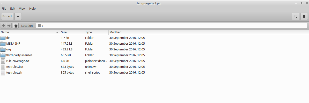

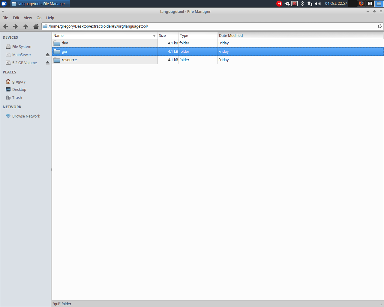

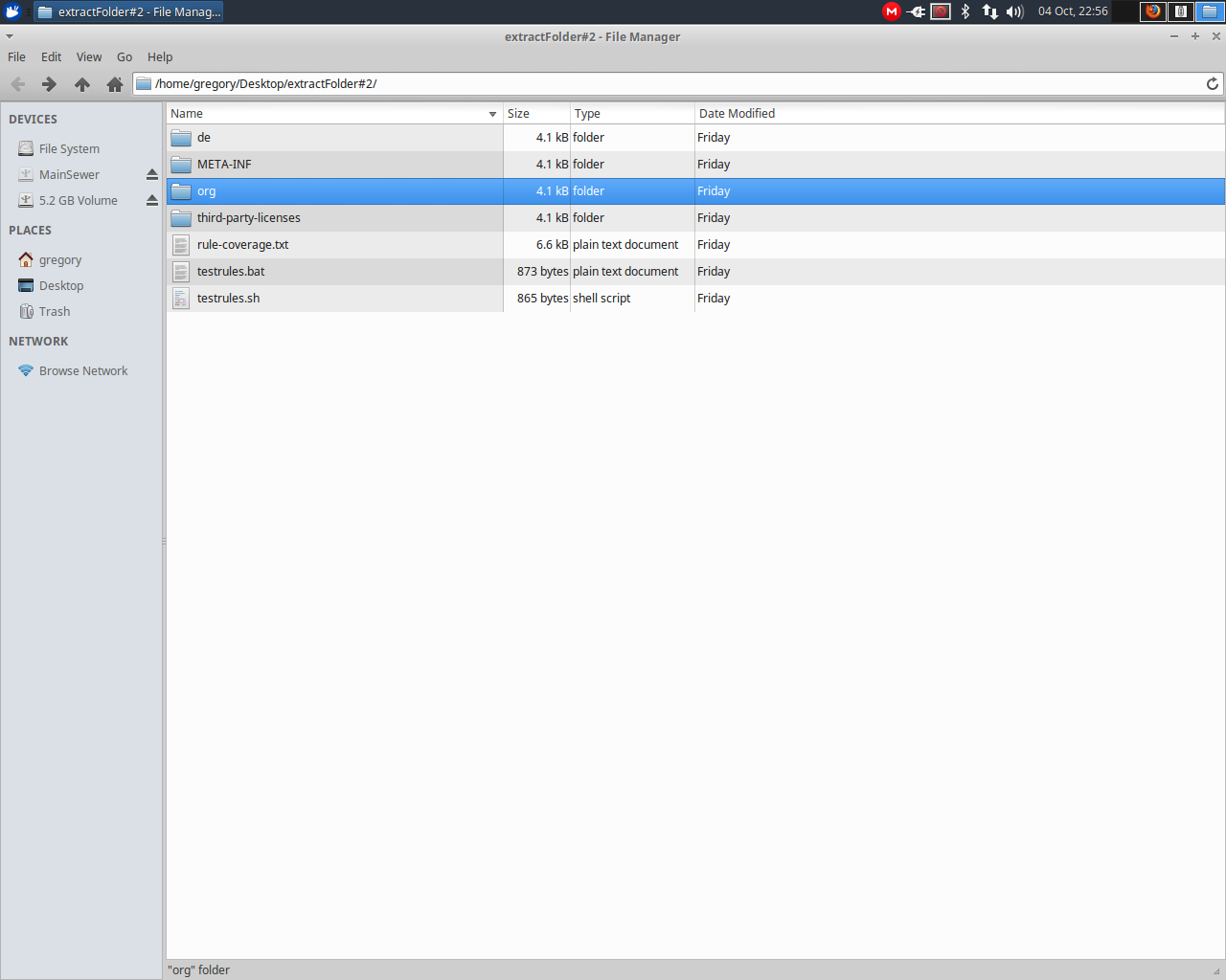

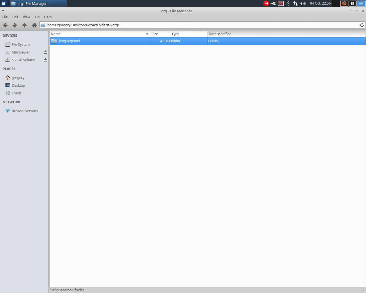

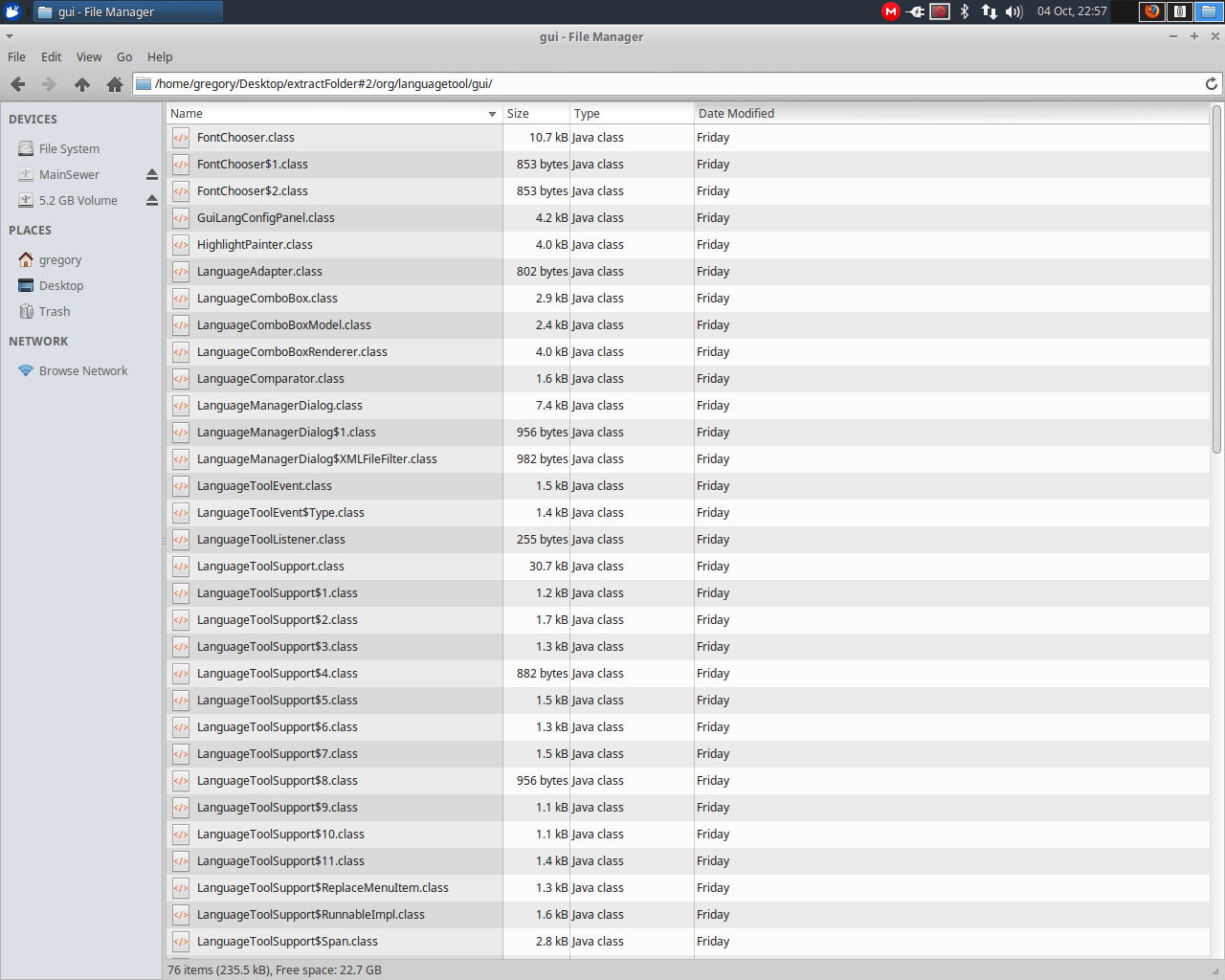

Doitsu, I unzipped the Language Tool 3.5 zip and double clicked on languagetool.jar.(which is a zip folder) That only showed what's in screenshot 176.
Anyway, I extracted that and (and remember I'm on Xubuntu) and that led to 177 (the Org folder) and clicked on that and that led to Language Tool folder (178) and clicked on that and that led to the gui folder (179) and clicked on that and it led to a lot of files (180).
Did I do something wrong?

Unfortunately, I can't help him either because I have an Arch Linux based distro, which by definition always has the latest versions of everything. (It's installed on a 64bit machine and I only have one option in the Java Options menu. See screenshot for details.)
@Gregg Bell: Try the stand-alone LanguageTool version. If it works, ask in an Ubuntu/LibreOffice forum for help.
Also enter the following command:
sudo apt-get install libreoffice-java
This will install the libreoffice-java package, if it isn't already installed.
