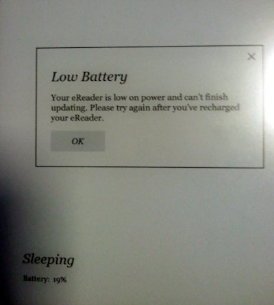

Originally Posted by frostschutz View Post
This morning my H2O greeted me with a window atop the sleep screen, "Your reader is low on battery and can't finish updating. Please retry after charging" (or something along these lines, the message disappeared before I could write it down). It lost its charge overnight down to 8%.
That's with automatic sync updates disabled.
Managed to get a picture of the message this time. No clue what it thinks to be updating.
I know I'm not supposed to be running this firmware on my H2O...
Let's see if there will be a fix next week, otherwise I'm going back to 3.x.

Old 09-24-2016, 11:11 AM   #144
Posts: 51,083
Karma: 179232776
Have you tried manually disabling the autosync feature? To do that, under the [ApplicationPreferences] heading, you add "PeriodicAutoSync=false" (minus the quotes) as the GUI autosync disable is not working -- you remove the checkmark and it does not stay removed.
Old 09-24-2016, 09:10 PM   #145
davidfor
Posts: 24,905
Karma: 47303826
Location: Sydney, Australia
What happens if you start the sync manually? Does it try to download the update? Does the info screen show the correct version number?
I'd recommend downgrading. I mean, you are using a firmware that was never intended for your reader.

Old 09-25-2016, 12:53 AM   #147
MGlitch
Posts: 2,864
Karma: 22568612
Join Date: Aug 2014
Especially when we know -a- new firmware is being released in a few days. Granted we don't know if it'll be available for all the devices, but it's meant to resolve at least the battery drain issue some folks are experiencing. Maybe it'll resolve the responsiveness issues as well.
It syncs. It's registered properly. There is no update.
4.0.7523 (c213e8a341 9/2/16)
That looks right. I assume when you tried the manual sync, the battery was well charged. It might be different if it is low. The other thing would be to turn the logging on and see if that shows anything.
