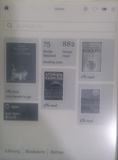

On my Kobo Glo FW ver. 3.19.5761, when I connect the device to Calibre (ver. 2.67 64bit Win10) I am getting the message : "Failed: Backing up Kobo device database".
Is it a sign of database getting corrupted? Should I backup all my notes and highlights and books immediately to avoid any upcoming disasters? Kindly advise.

After a few trials, I succeeded in replacing a two months old backup of database on the device, and got my reading stats (partially) back. Thank you again, davidfor, for the help!
