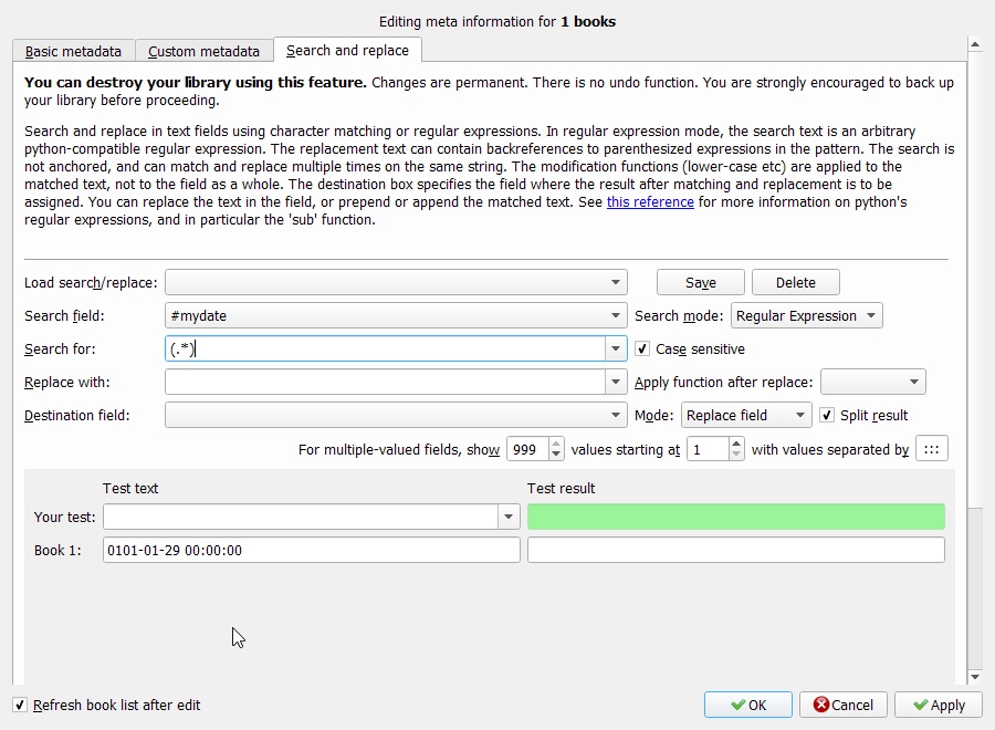

A custom column date can be cleared via the purpose built button that is automatically created in the Bulk MDE Custom Columns tab. But it would suit my purposes better if I could do it via saved Bulk MDE S&R definition. I have two related Bulk S&R definitions - a_move_date, b_counter++ - this would be a third - d_clear date
So I am looking for a Bulk MDE S&R definition to clear a custom date

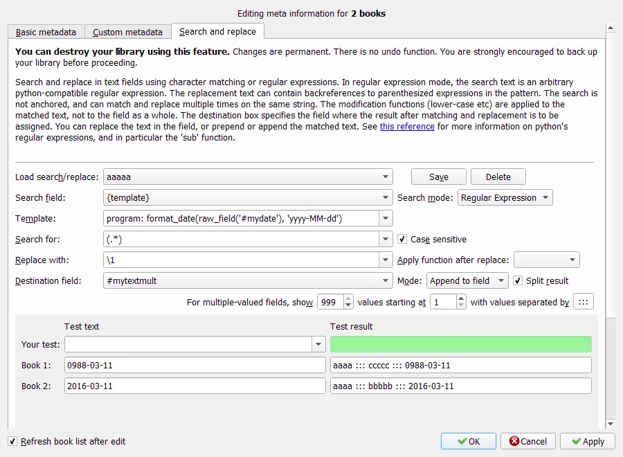

So the question is - can someone furnish a Bulk MDE definition that will convert a custom date value into to a 'YYYY-MM-DD' string and append it to a custom tag-like value.
I would name the definition c_save_date
So now I would have the following definitions -- a_move_date, b_counter++, c_save_date, d_clear date -- that I would execute consecutively in that order.
See attachment 1. Note that there is a problem with the current release of calibre where the date isn't cleared properly. I have submitted a fix.
See attachment.
