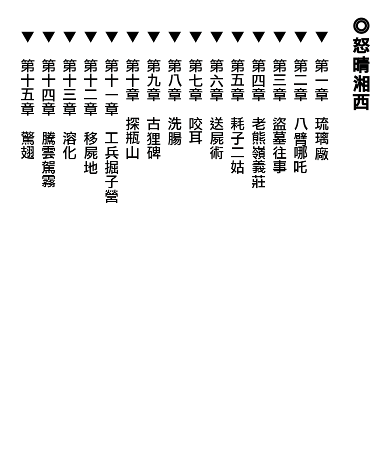

This is a text viewer (in essence, it's a pdb file viewer, not a text file reader) that is specifically targeted at displaying traditional Chinese glyphs vertically on iLiad. If you don't read traditional Chinese, you can ignore this thread, because it's useless for you.
Chinese text can be displayed horizontally and vertically, and I personally prefer vertically displayed text, so I make this program.

1. 電子書打開後,前幾頁是書的目錄,每一章的章名上面有一個"▼"符號,點它可以直接跳到那一章 。
2. 銀幕被分成3X3的九宮格,從上到下、從左到右編成1到9號,1是翻上頁,2是結束程式,3是 翻下頁。但要注意如果在目錄頁,從上方算起100pts被保留給章節目錄,要翻頁得點下面一些。4到6暫時沒用。7到9只在第一頁時有用,7是縮小字型,8是叫出字型設定對話框,9是加大字型。
