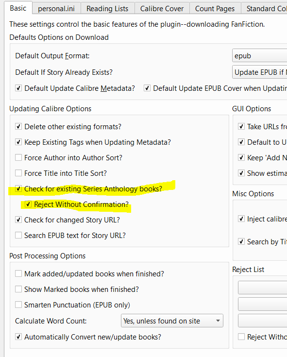

New test version posted (direct link)
2016-09-08
- Adding Update Existing Only option to Email URL Fetch.
Hi Jimm,
While were on the subject of email fetch lists this, would it be possible to skip Anthology's auomatically without having to click "yes" every time?
Mieeka
Mieeka is offline   Reply With Quote
Old 09-18-2016, 01:03 PM   #1500
JimmXinu
Plugin Developer
JimmXinu's Avatar
Posts: 7,644
Karma: 5010733
Location: Midwest USA
I can't easily add that option for email fetch only, but I can do it in general.
2016-09-18
- Add option to Reject without Confirmation when checking for existing series anthology.
