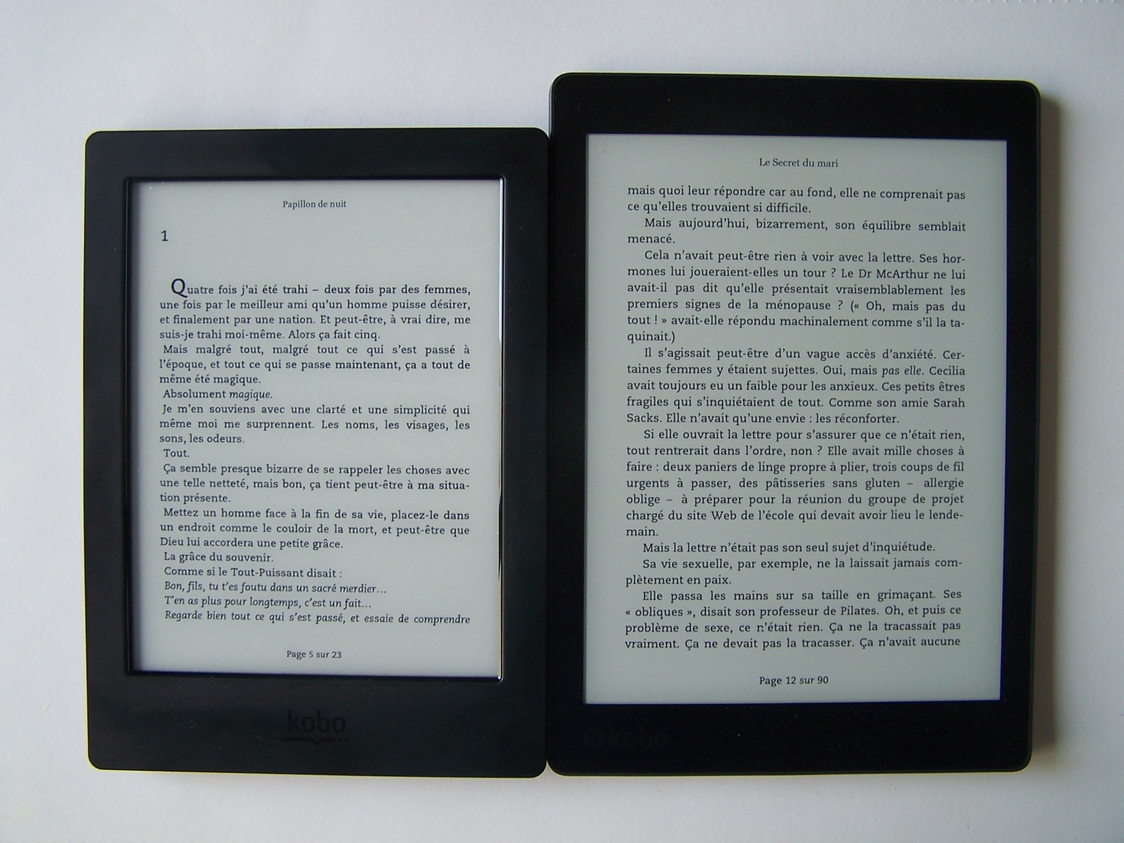

Device: Kobo Aura H2O - Nook Touch Glow
Quality of the eInk Carta Aura One screen less than the H2O?
See comments in french at
http://aldus2006.typepad.fr/mon_webl...t-complet.html
Could someone compare the screens of One and H2O? Thanks
See post #181 in this thread. With light off, the screen is very slightly greyer/yellower in the One (probably because of the capacitive layer), but already at 20%, the One is better, and at 50% it is much better. At night the One is much better than the H2O and the Glo HD.
I don't own one, but it might be due to the One having an added layer -- the capacitive one IMO. For example I own a H2O and a Paperwhite 3, both with Carta screens and the PW even has a higher DPI, but the H2O screen looks much whiter, and has better contrast.
mathil is offline   Reply With Quote
Some screenshots found on the web:
http://aldus2006.typepad.fr/.a/6a00d...219a30b970c-pi
http://aldus2006.typepad.fr/.a/6a00d...9335bb7970d-pi (H2O on the left)
http://aldus2006.typepad.fr/.a/6a00d...9326def970d-pi
http://allesebook.de/wp-content/uplo...s-aura-one.jpg
source:
http://allesebook.de/testbericht/kob...en-test-69985/
I'm also interested in additional comparison. As far as I can see, the background is clearly less white on the 7,8'' device and my overall impression of the screen is a disappointment (compared to the two-years-old H2O).
