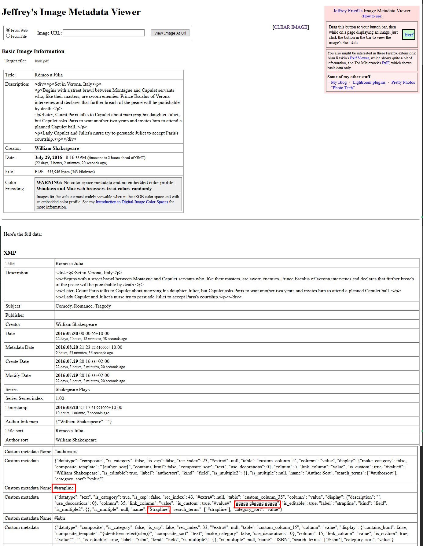

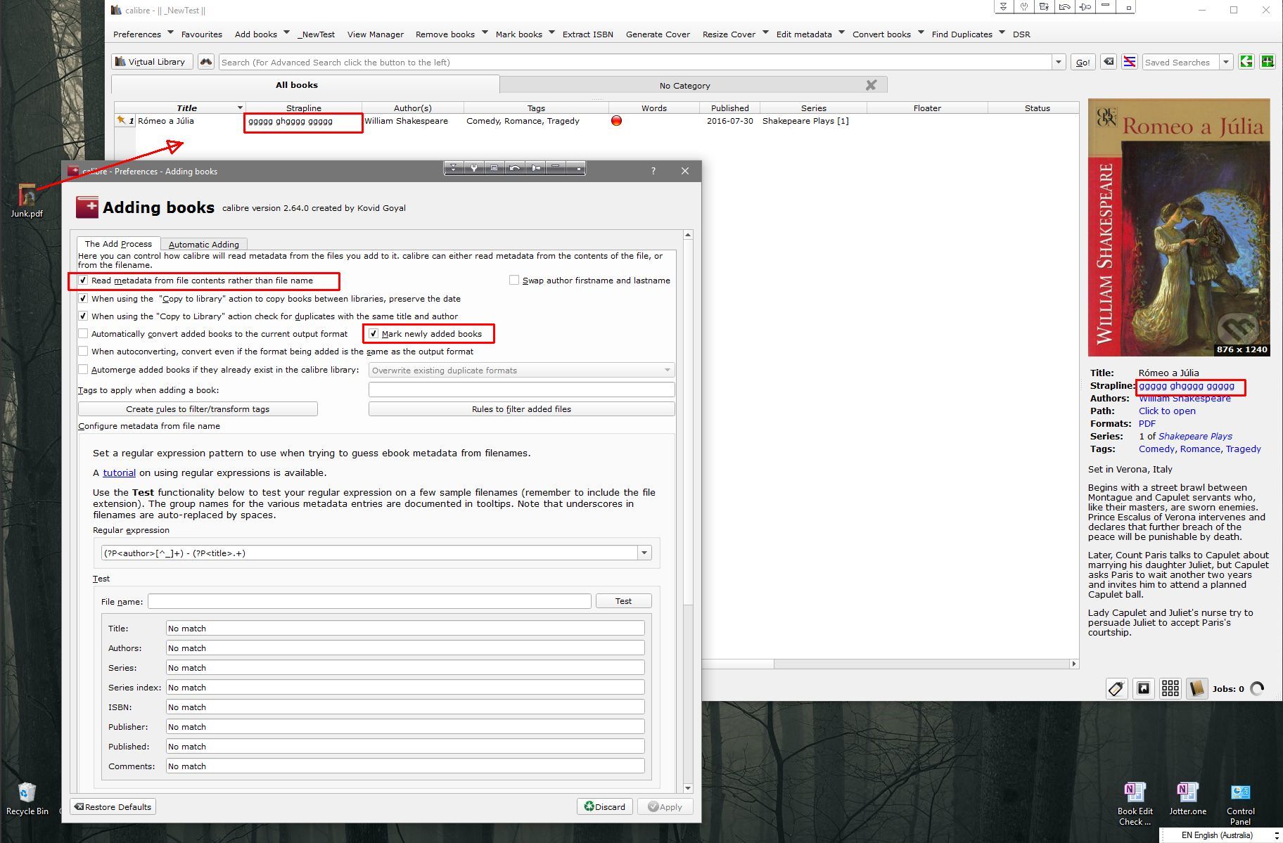

@canpolat - when I re-added the book I deliberately changed the name of the file, there is no evidence of that name in the added book, so everything had to come from embedded metadata.
Essentially I copied a PDF (Romeo a Julia - William Shakespeare.pdf) from my test library to the desktop, renamed it to junk.pdf, and added that file to an empty clone of my test library. The following image demonstrates that.
The following is from Jeffrey Friedl's Metadata Viewer

@BetterRed, my "Adding books" preferences are identical to yours (the ones in the red rectangles).
@kovidgoyal, Thank you for your reply. Both of those settings are set in my installation.
