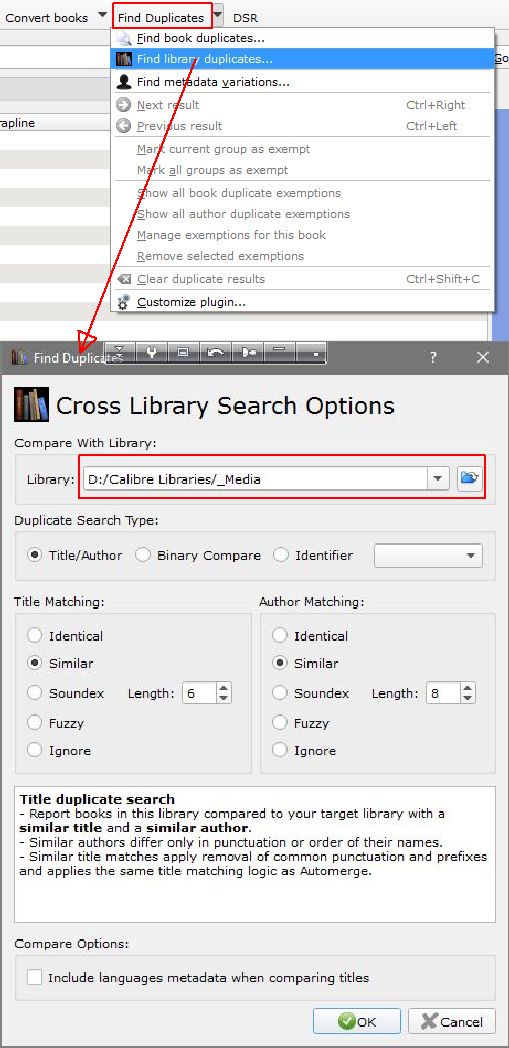

@Teeny - via its Find library duplicates option, this plugin can also search for a duplicate identifier, in addition to duplicate title and/or author viz:

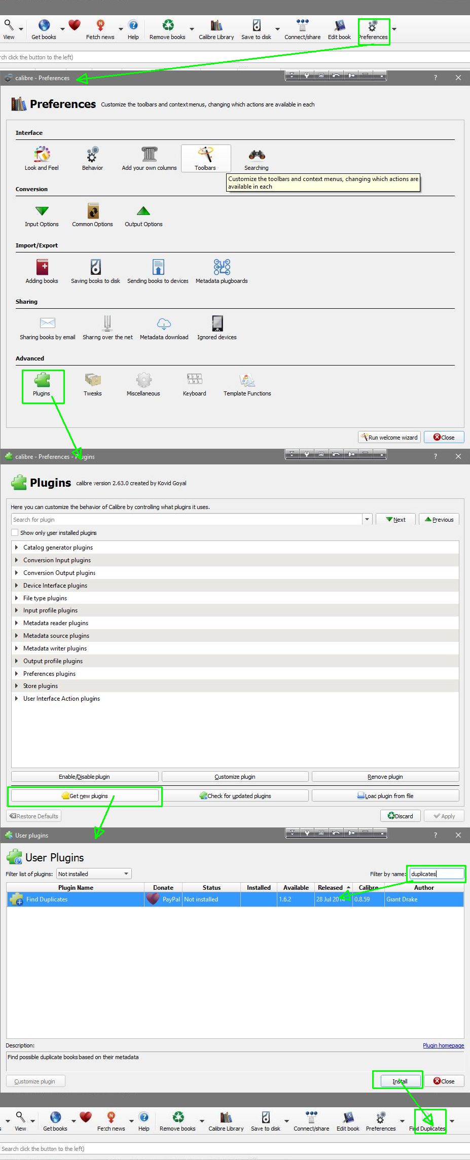

Hello, I am an old lady and I am trying to put the plugin in the calibre 2.63 64 bit by David Koval (that is what it says at the bottom left of the screen. I have the plug in downloaded it to my extra hard drive and I unzipped it. I can delete that and redownload. I understand I messed up. I tried downloading it to program files and calibre plugins, but the computer told me I couldn't. So where do I download it?
But my issue is I cannot find a button or link on the preference like it says here "In Calibre choose Preferences->Plugins. Click the Load plugin from file button (Calibre 0.8.6 or later) or Add new plugin button (Calibre 0.8.5 or earlier) to browse to your plugin .zip file and click OK." All I got on the user plugins page is a link to this plugin homepage. and a greyed out button that says customize plugin and 2 buttons that say install and ok. I have NO plugins installed so.... Can someone please help me?
Thank you.

In Calibre
  • click the Preferences icon in the tool bar,
  • click the Plugins icon (bottom left corner),
  • click the Get New plugins button (bottom left corner),
  • type 'duplicates' into the Filter by name box (top right corner).
  • now you should see Find Duplicates as the only item
  • click Install
  • click Yes/OK to subsequent messages
  • do the Restart
Now you should have a Find Duplicates icon in your toolbar. Attached image shows above as composite screen shot.
Attachment 150762
Ah see I was an idiot and I have my other libraries outside of the folder Calibre Library... 2x for poor judgement xDD
