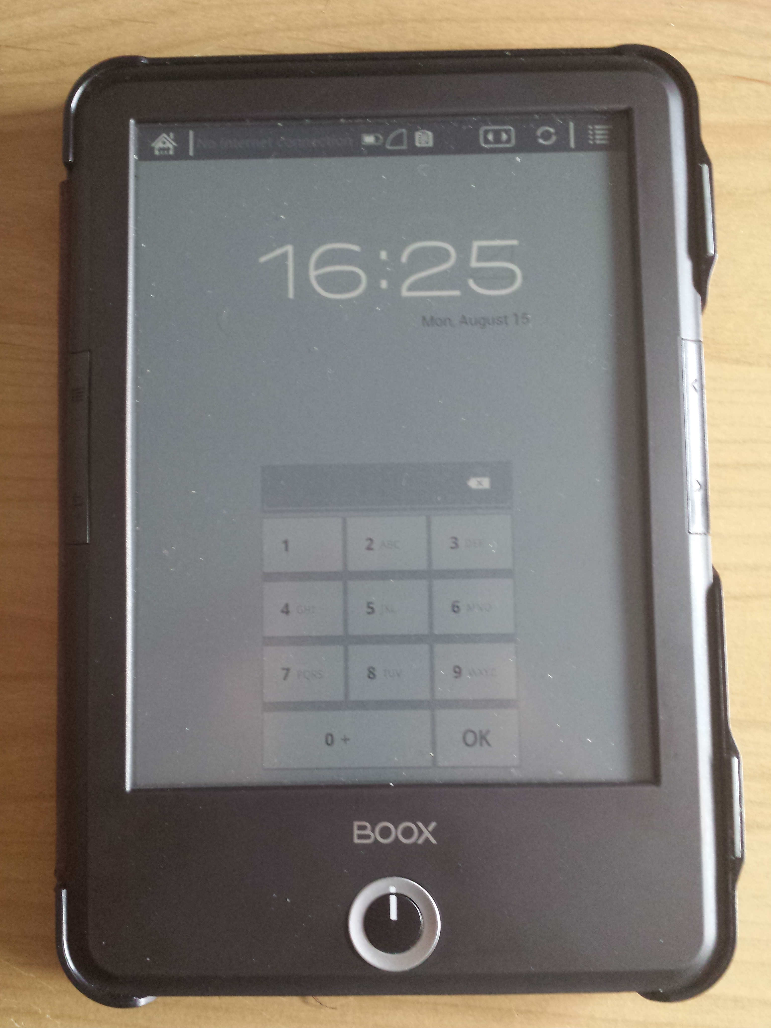

Now it works fine for me as well: I've upgraded simply on the last firmware. Now I'm looking for the file of the lock screen, because I want to make it black and white. I've edited the file keyguard_screen_tab_unlock (framework-res\res\layout) but nothing changes: do you know maybe what file I should edit? Thank you anyway for your interest!
