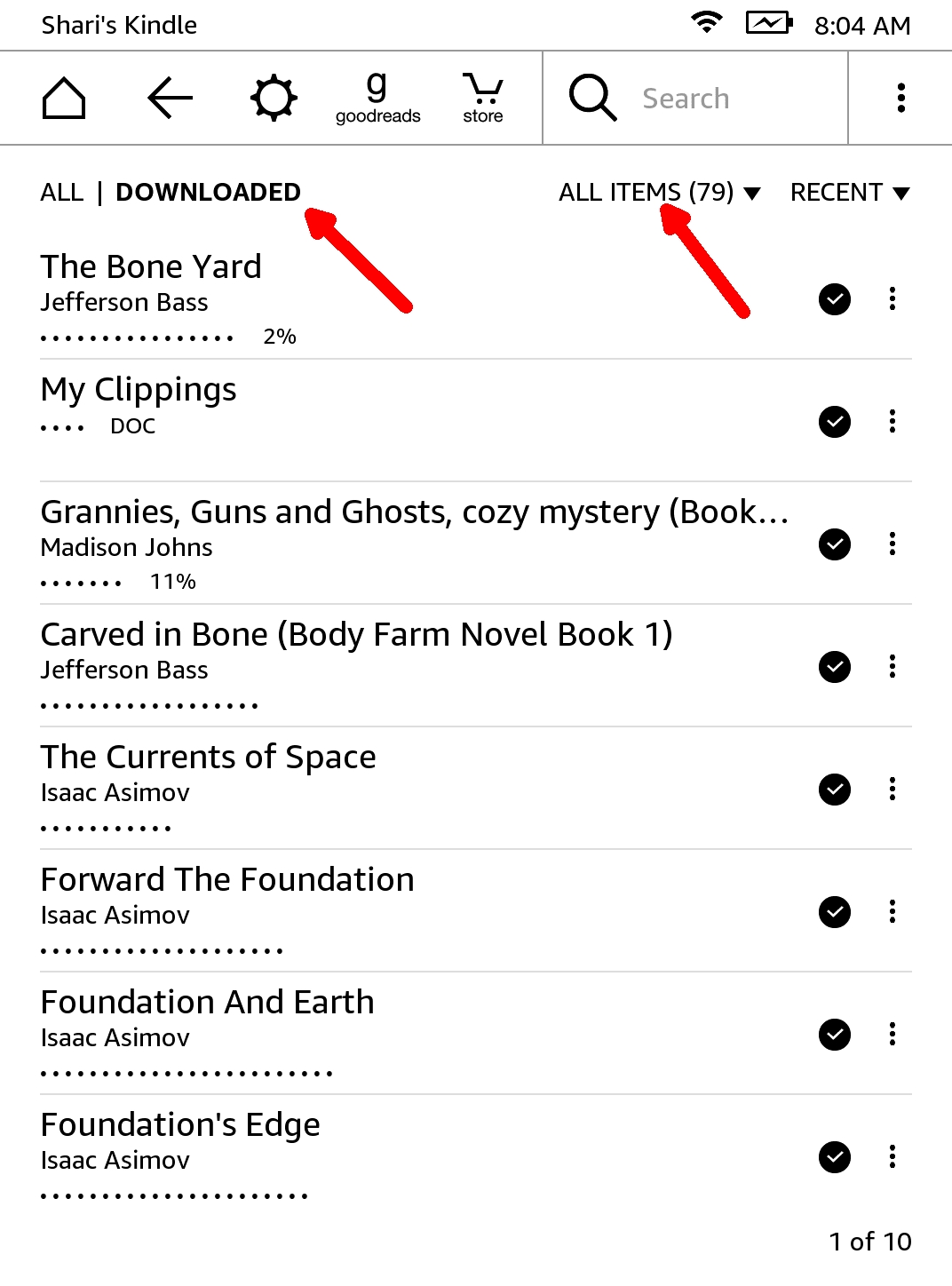

Originally Posted by Siavahda View Post
I think so. All my books show up when I have it set to 'downloaded' and that is how it is set now; I can see all my other books. When I have 'all' on I can only see those books bought from Amazon.
It should set to "downloaded" in the far left dropdown, then "all items" in the middle column. Take a look at the attachment for a visual explanation.
Shari
