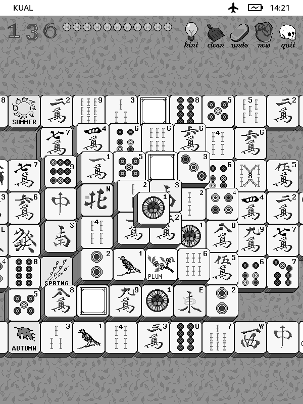

I got forward with that one. Attached a wrapped Kual extension, that can start it but you do not see the window as it is below of all other windows

That gets the window above the home window. You can see it, but the touches are not send to it. When you stop the game with ctrl+c in the other shell window you see that your touches where record and now send to the home window.
[root@kindle root]# /mnt/us/extensions/xmahjongg/bin/wmctrl -r xmahjongg -b toggle,above
then wait about 30 seconds and the game window will pop up. It is payable, but the graphics is messed up for whatever reason.

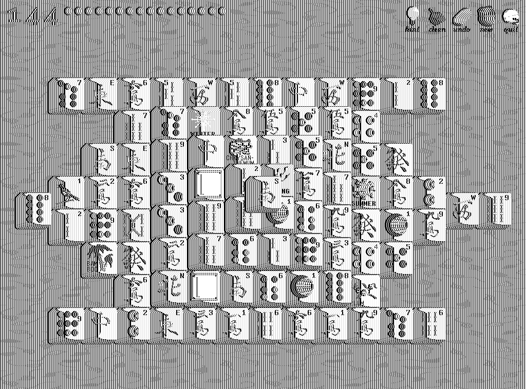

when I start:
./xmahjongg -d 0 --name L:A_N:application_ID:com.xmahjongg_O:R_PC:N -B /mnt/us/extensions/xmahjongg/data/
It is working, but the display is a little bit messed up as you cann see in picture one.

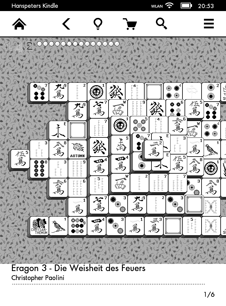

As soon as I re parent it to an existing Kindel windows the display is fine, but it dosend accept any touches any more. When I then stop the program the touches was queued somewhere and now sent to the underlining window.
Re parent command to home windows:
/mnt/us/extensions/xmahjongg/bin/xdotool windowreparent 0x1600004 0x1200026
The result is seen in picture 2
I also attach the Kual extension that start the playable app with the messed up display as in picture one.
Hope that somebody has an Idea how to tell the app, perhaps by an environment variable, to set the right color depth. I expect that is the problem.

First guess would be the attributes or the parent window. The Parent Window could be the problem as a reparent to a other window works.
Also Line 343 and following looks interesting as it it talking about the color depth:
    for (int i = 0; i < nv && !best_v; i++)
    if (v[i].visualid == default_visualid)
      best_v = &v[i];
  if (!best_v) {
    visual = DefaultVisual(display, screen_number);
    depth = DefaultDepth(display, screen_number);
    colormap = DefaultColormap(display, screen_number);
  } else {
    /* Which visual to choose? This isn't exactly a simple decision, since
       we want to avoid colormap flashing while choosing a nice visual. So
       here's the algorithm: Prefer the default visual, or take a TrueColor
       visual with strictly greater depth. */
    for (int i = 0; i < nv; i++)
      if (v[i].depth > best_v->depth && v[i].c_class == TrueColor)
	best_v = &v[i];
    visual = best_v->visual;
    depth = best_v->depth;
    if (best_v->visualid != default_visualid)
      colormap = XCreateColormap(display, root_window, visual, AllocNone);
    else
  if (v) XFree(v);
I would try to comment out or delete the if /else at the end that it always requests the DefultColormap.
      best_v = &v[i];
  if (v) XFree(v);
First guesses from looking inside the code quickly with no skills in x-Windows programming
Some docu about xLib programming: http://www.sbin.org/doc/Xlib/chapt_03.html
HaPe

Old 08-13-2016, 09:33 AM   #30
sguerrini97
sguerrini97 began at the beginning.
Posts: 27
Karma: 12
Join Date: Jan 2016
Device: KT2
You were right about the color depth, with the default one the window is not messed up
I launched it from the ssh session.
Still some of the tiles are out of the screen, I tried to change some values that I tought were the sizes but I don't see any changes.
