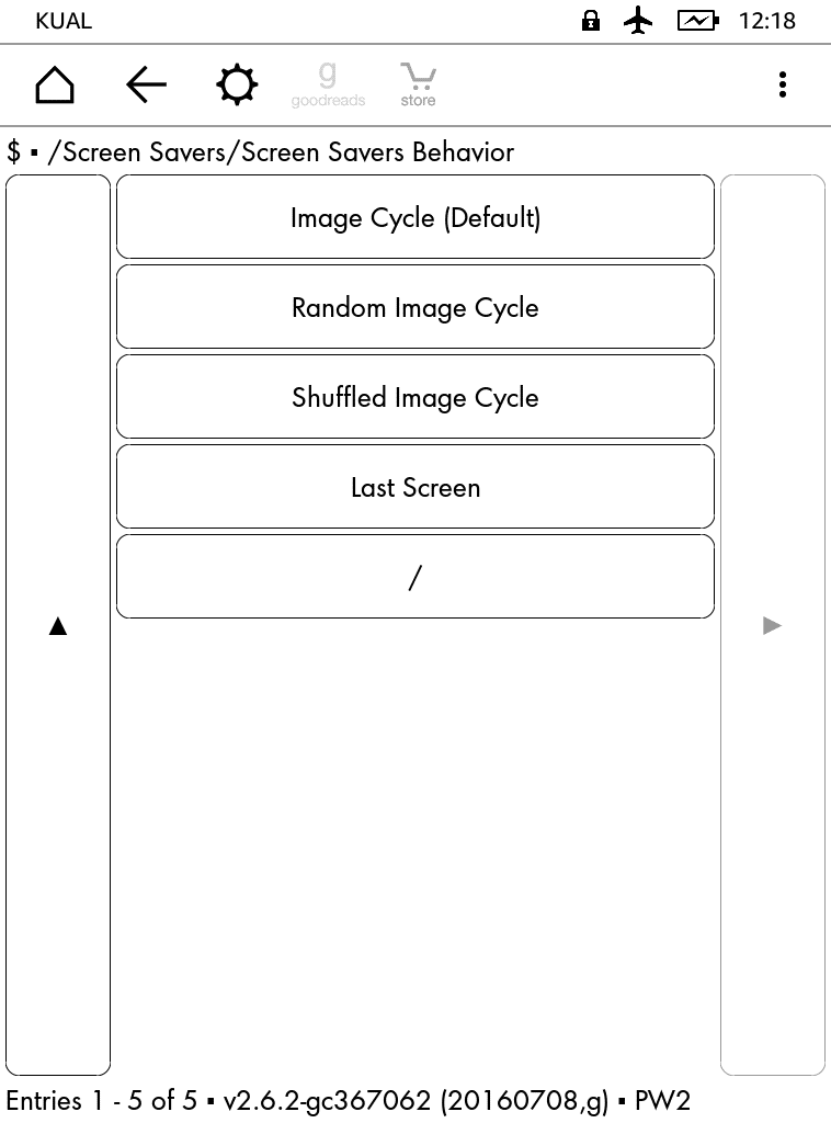

@abasba: Think of KUAL buttons as radio buttons: what you see on a button is the action that'll happen *after you tap that button*.
Since most of the configs are mutually exclusive, that means the the stuff you don't see a button for is the config currently active.
TL;DR: To be in image pool mode, you should see the cover mode button in KUAL.
EDIT: For instance, in that screenshot, I'm currently in Cover mode (the only option there's no button for).
You want to switch to "Image Cycle" mode.
Mine is in image cycle mode too.
Still no luck.
