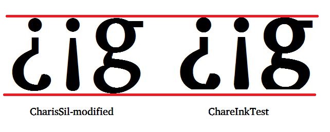

ChareInkTest issues
Found three small issues

Old 07-05-2016, 11:29 AM   #56
Posts: 85,317
Karma: 154365101
Try increasing the line height. That should solve the problem.
What reading software are you using? I'm using some version RMDSK (ADE) with my H2O and the font displays descenders no problem.
But if need be, I could adjust the metrics to give a slightly larger line-height.

Are these glyphs going outside the em-square of the font at all?

A picture is worth a thousand words.
A screenshot taken from WordPad with the font size to 100.
(I have also pointed out the problem with red lines).
The reason for this is because I've upped the weight and the metrics were not changed. I'll have a new test version soon.

Newest test versions
I've posted another test version that should have the descenders fixed. Also, the weight has been upped slightly. I've used Windows Font Viewer to check and the descenders look good to go.
Feedback would be appreciated. Thanks.
