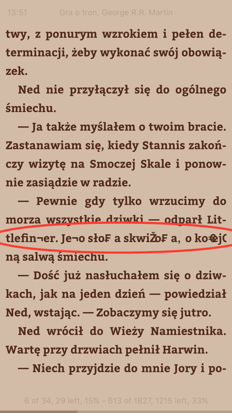

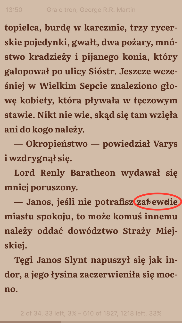

Another probably SHY related bug. Check attached screenshots. The problem is visible with Bitter font and sideloaded Literata font.
ID:	149579   Click image for larger version
ID:	149580   Click image for larger version
ID:	149581   Click image for larger version
