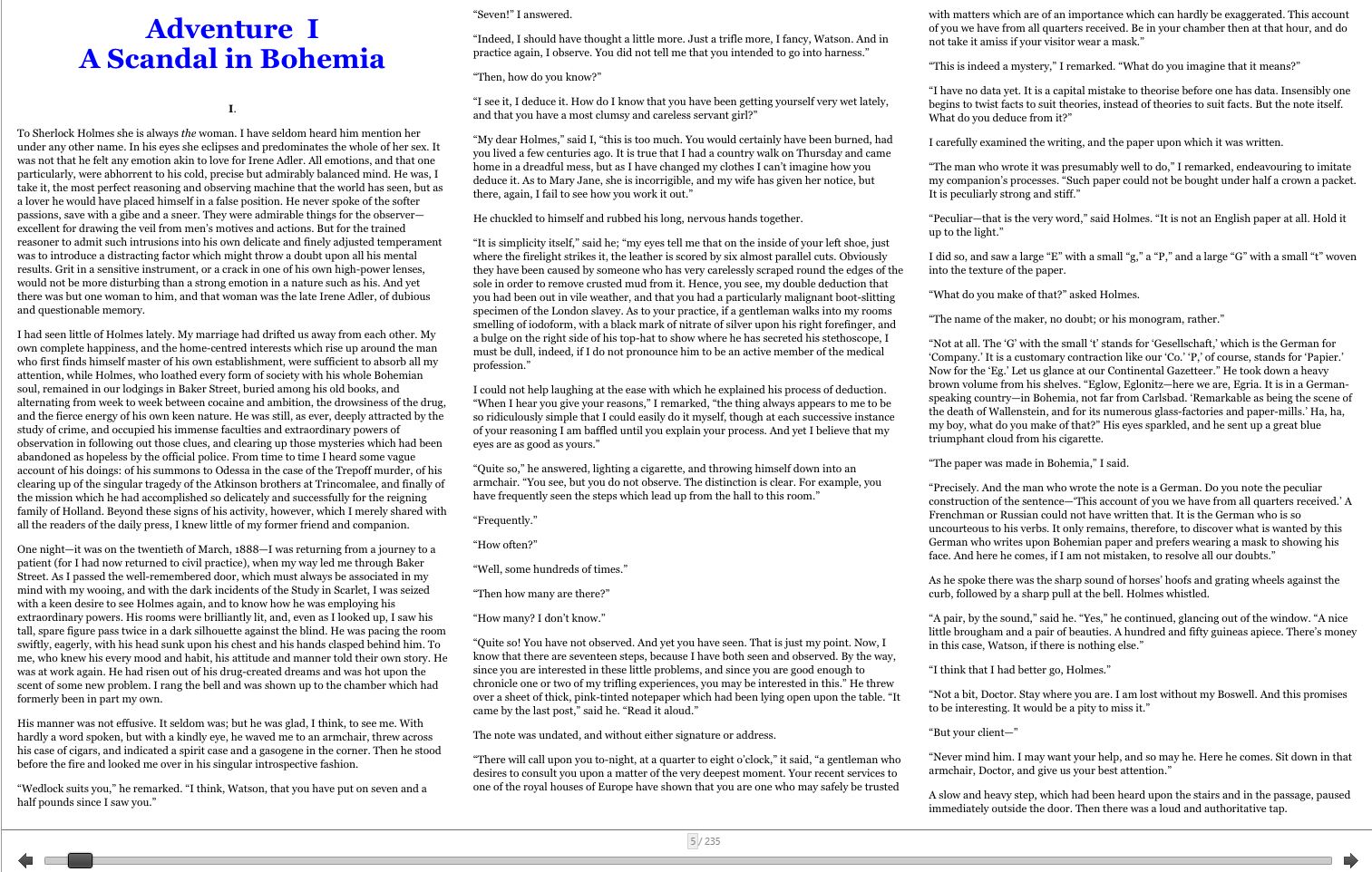

phossler
Posts: 1,092
Karma: 447222
Device: Kindle Paperwhite
ADE 4.5.1 does support hyphenation. The version of ADE used by Kobo supports hyphens. You don't need to add soft hyphens to ePub for them to work.
The I must be doing something wrong. Attached is a screenshot of an epub in ADE 4.5.1.
There is no hyphenated word that I can see in 3 columns. I'd expect there to be at least one in all that text??
Old 05-11-2016, 05:32 PM   #274
Posts: 82,555
Karma: 151278869
With Kobo Readers, they are using a version of ADE later than 2.0.1 and will not hyphenate when the text is left justified. So try full justified text to see if it hyphenates. Also, you really don't want to use ADE past 2.0.1 as you could end up with an ePub that has DRM that will cause you to not be able to remove the DRM.
