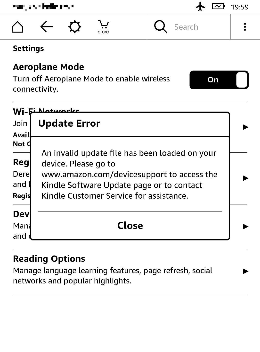

I put hotfix .bin file (JailBreak-1.14.N-FW-5.x-hotfix.zip attached to THIS post, then extracted) but after I eject the device I get the update error.
I don't exactly remember applying the hotfix after jaibreaking on 5.6.5 (but I see a hotfix file in my kindle-stuff folder that was created on the same day I performed JB so I'm pretty sure i did so; I updated my device several days ago). Let's suppose I did not apply that. What then? Serial JB?

Serial jail break.
If it had been installed, you would have seen an on-screen message about the jail break being re-installed during the re-boot after the Amazon update.
We are trying to tell the difference between:
*) Message was there, but you didn't notice it
*) Message was not there.
I am betting on #2 right now.

@sk8terek: Assuming you don't have an exotic PW3 variant (check the wiki), in which case the hotfix install would have failed the first time around, too; then yeah, you're screwed.
