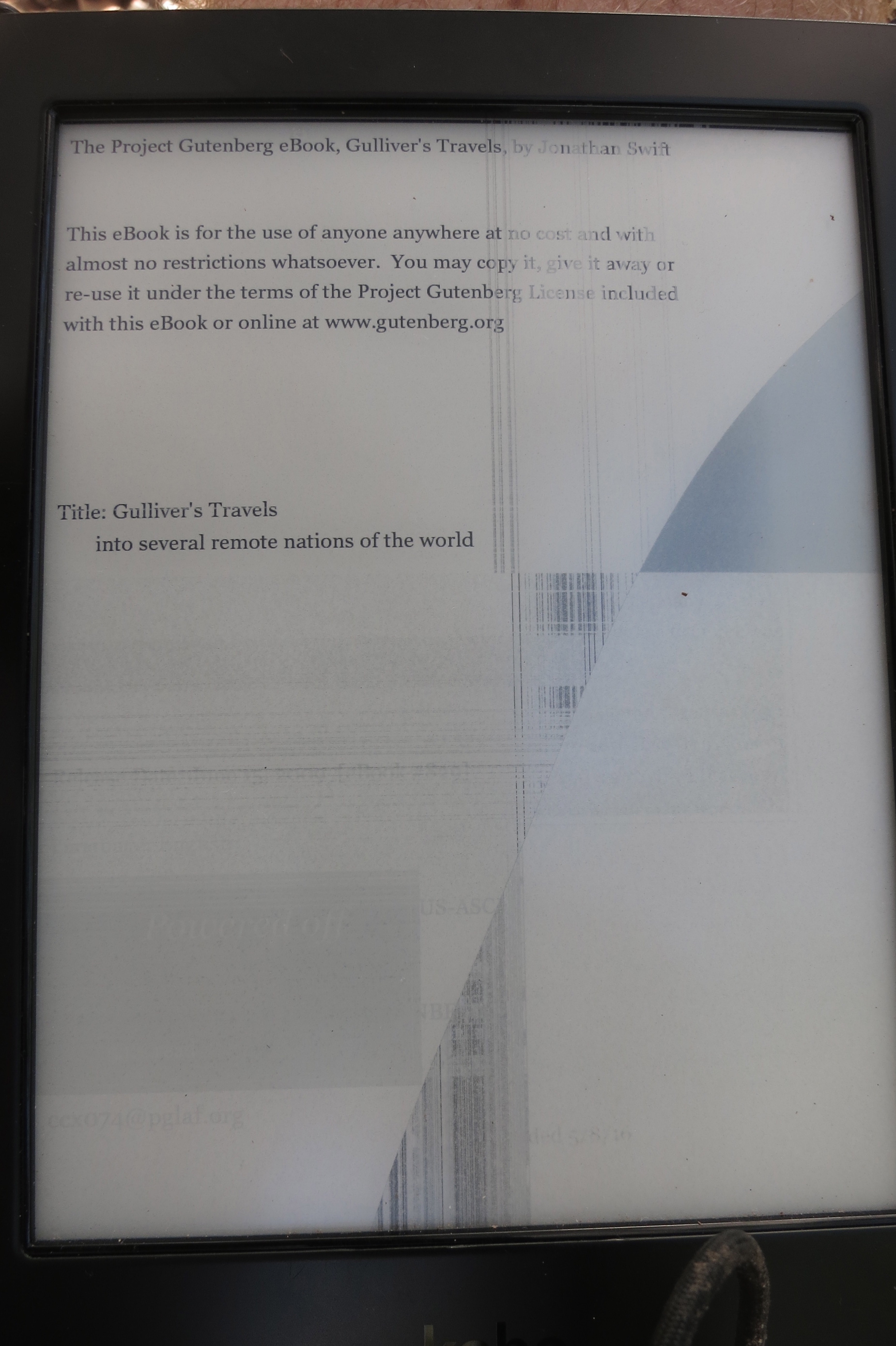

This post is regarding a Kobo screen that froze after turning on and displays a distorted screen (see photo).
The device is a Kobo H2O I bought in November 2014. In the first year it had very limited use. In the last six months it's had moderate use (5 - 10 hours/week or less). It's always been very well cared for and kept in a cover.
Four days ago I turned on my screen and lines appeared all over it. The screen in the off state was normal and clear, but as I turned it on it was covered in lines/distortion (see attached photos).
Only a section on the bottom right shows an 'active' screen when turned on, but the touch commands appear to still work, as I can hit where the home screen button should be and it appears to go to the home screen.
I've tried re-booting it a number of times, re-setting with a paperclip and charging on a powered up computer, but nothing is working.
Any help on remedies much appreciated!

I'm afraid the screen is broken, it can't be repaired. There's a thin substrate layer of glass that can crack and that's what happened. It can crack if something put pressure unevenly on a part of the reader like when packing into a backpack or purse, or if the reader frame flexed, I've heard extreme temperatures can do it as well if you leave it out in your car in the extreme heat or cold.
Time for a new reader. All e-ink readers are susceptible to the screen cracking in this way.

You'd have to replace the entire display. Someone seems to be offering them on aliexpress for $83 but... will it arrive unbroken at your place? will you be able to assemble it properly? (it's finnicky, the screen is very fragile, and if not assembled properly the IR touch won't work either). Does it have the same quality as the original... also after opening the H2O it will no longer be waterproof.
If anything goes wrong you won't only have lost your reader but also the costly replacement parts.
Buying a new reader is definitely the hassle free option, and you might be able to get a few $ for the broken H2O on Ebay.
