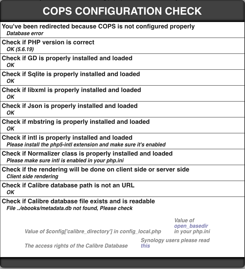

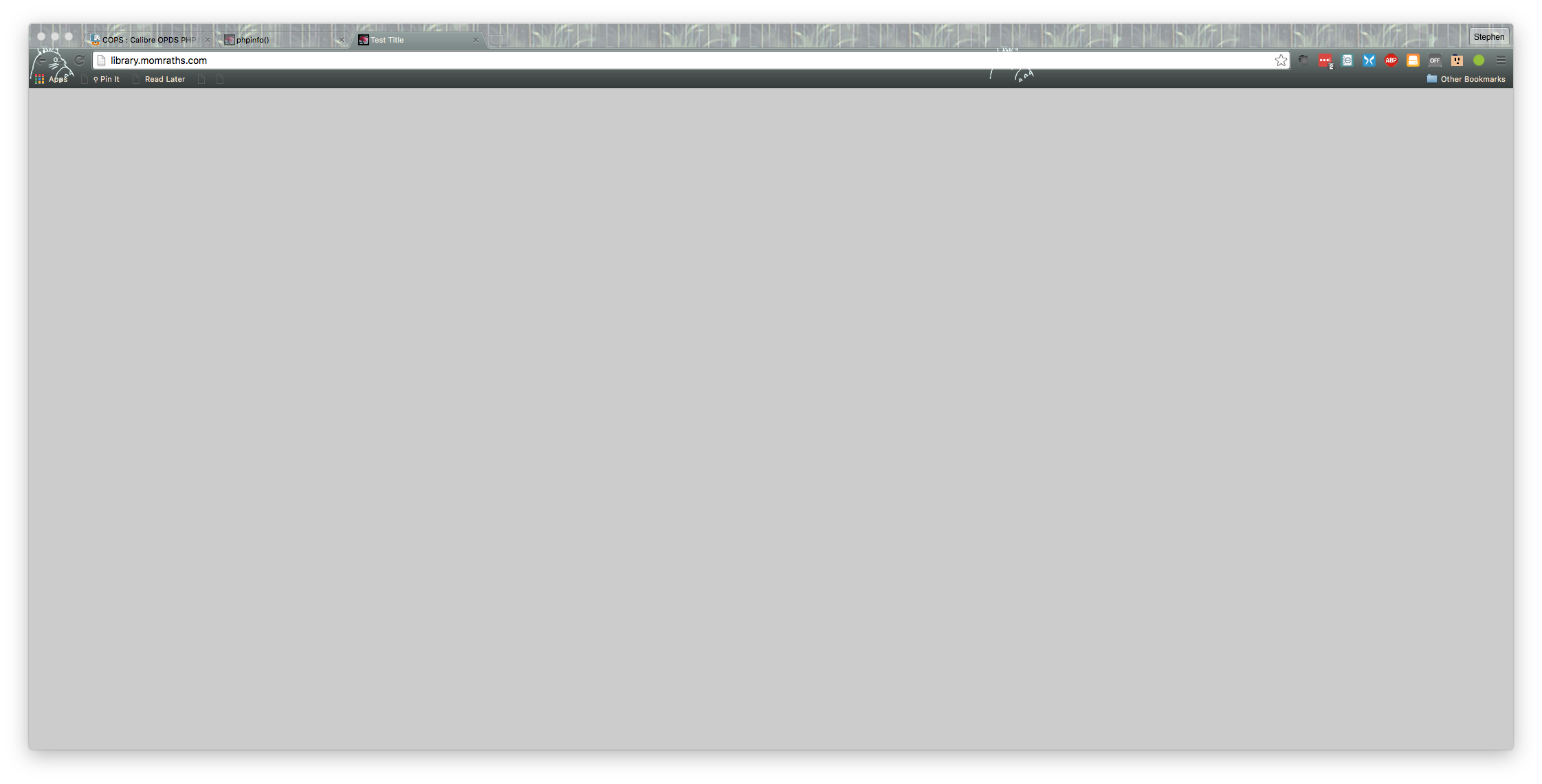

The directory structure is
/root/<cops files>
/root/ebooks/
Your first suggestion gives me the Configuration Check page and "File ../ebooks/metadata.db not found, Please check"
Your second suggestion gives me the grey screen.
I have tried every variant of path that I can think of. I've even renamed the ebooks folder, just to check that it wasn't something to do with the name itself.
sasilk is offline   Reply With Quote

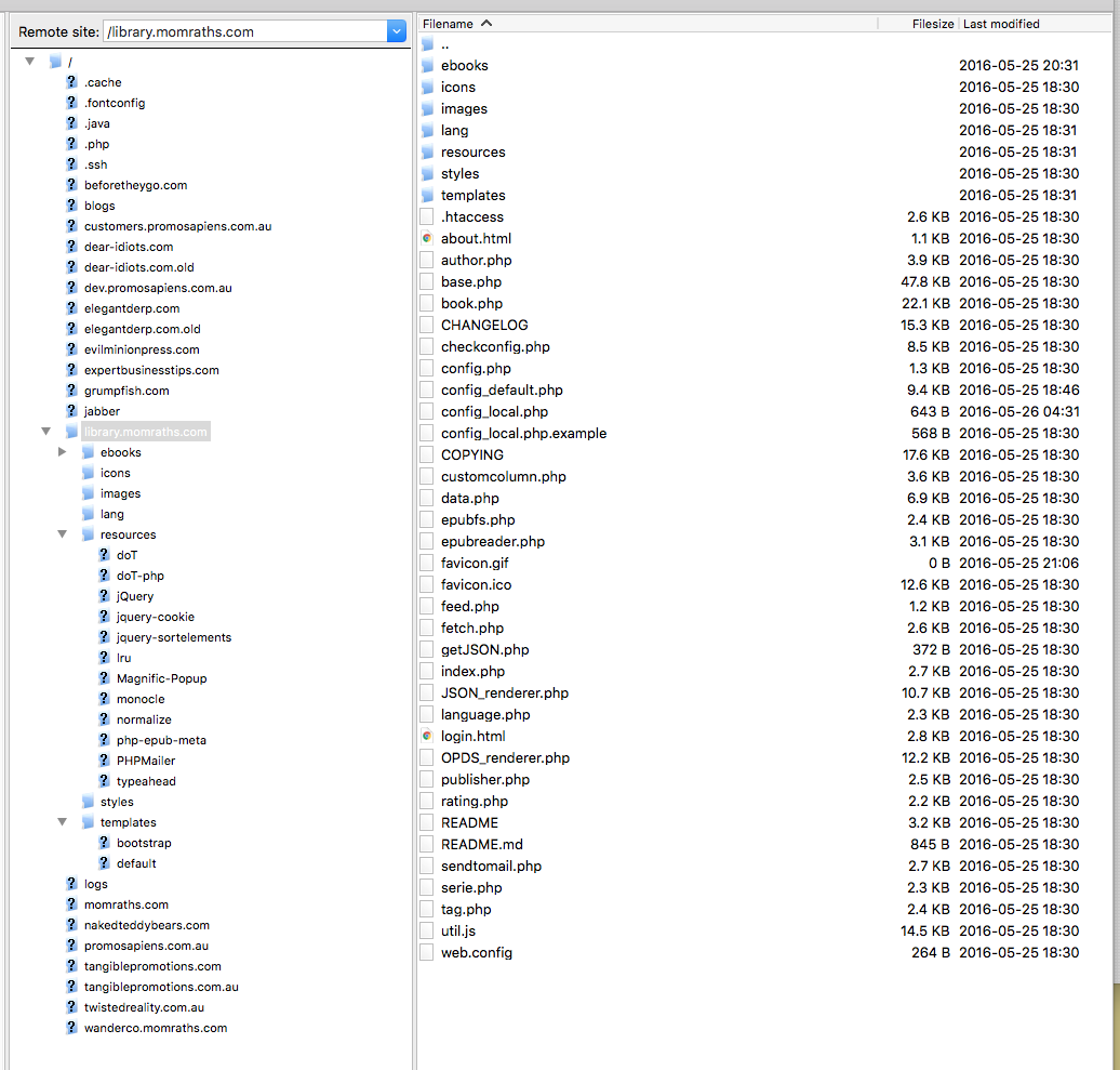

Directory structure screenshot
Screenshot attached

Result screenshots
The first screenshot shows the result of the suggested path "../ebooks/"
The second shows the result of the supposedly correct path "ebooks/"

Hmm, I thought I had a solution to your problem, but now I'm not so sure....
Based on your "directory structure screenshot" the relevant line in the config_local.php should be:
$config['calibre_directory'] = './ebooks/'
However that possibly leads to a grey screen on http://library.momraths.com and a strange error on http://library.momraths.com/checkconfig.php.
Or not, can you test?
For testing purposes the access rights on directories /library.momraths.com and /library.momraths.com/ebooks should be (at least) 755. But I suspect they already are.
Just to be sure, can you verify your Calibre Library in Calibre?
Did you use the latest cops version from github?
[I'm not the developer, just an enthusiastic user with some knowledge]
mariosipad is offline   Reply With Quote
