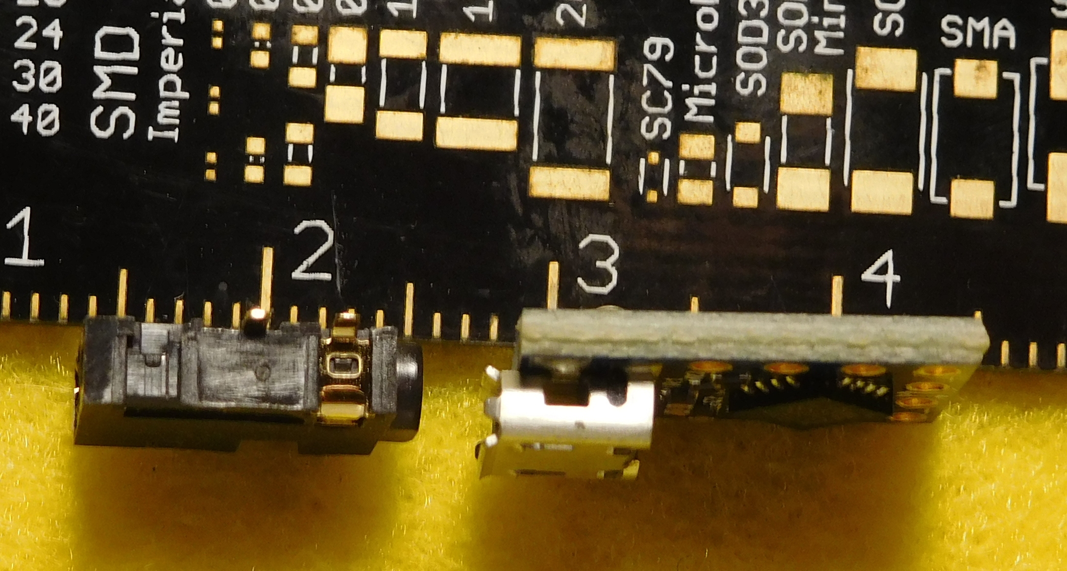

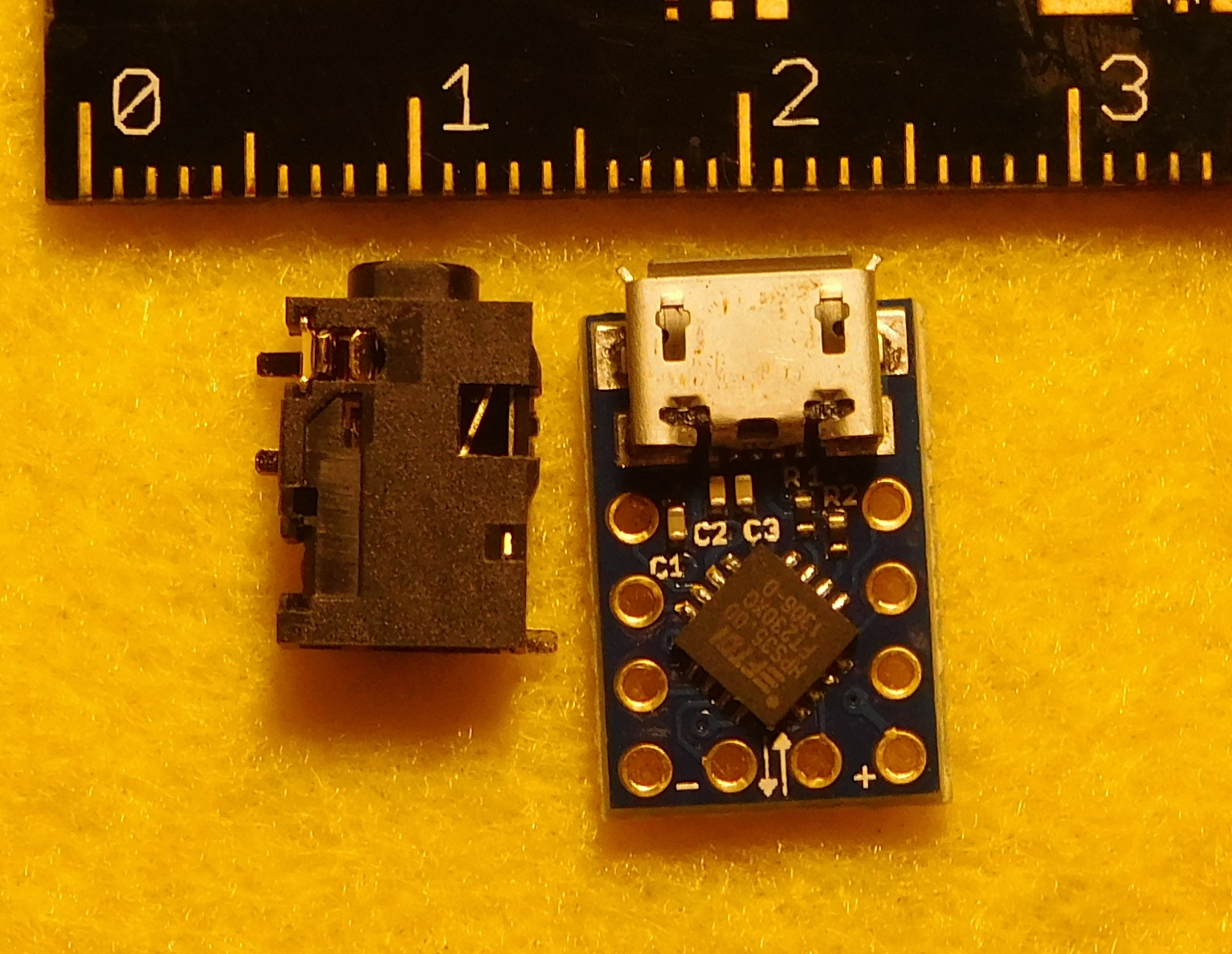

Just now.
I am off to see if this stereo headphone jack is small enough.
Will compare it to the USB adapter I built-in on my own.
Later:
The documentation said this was a low profile, compact, three wire jack.
The adapter cord only requires three leads to be brought out of the Kindle, so this tiny 'headphone' serial port jack should do just fine.
See attached.
No lies there, it is smaller and lower profile than the jim.sh/ftx adapter.
So I **should** be able to get it inside of the PW-3's case.
It may not fit in the same place I used for the adapter on my PW-3 -
because of that step in the frame where the e-ink screen is at.
But it is going into the case somewhere.
ID:	148872   Click image for larger version

Old 05-23-2016, 08:52 PM   #90
knc1
Going Viral
knc1's Avatar
Posts: 17,212
Karma: 18210809
Location: Central Texas
Device: No K1, PW2, KV, KOA
Originally Posted by Cinisajoy View Post
Oh and yes, the baby block worked.
The new serial port connect is **small** -
The bad:
I have to invent a new way to mount it in the case (its almost two small).
The good:
With its size, there are a lot of choices.
The ugly:
That smooth curve of the side-to-back edge all around the Kindle.
That is going to make mounting the tiny jack extra interesting.
