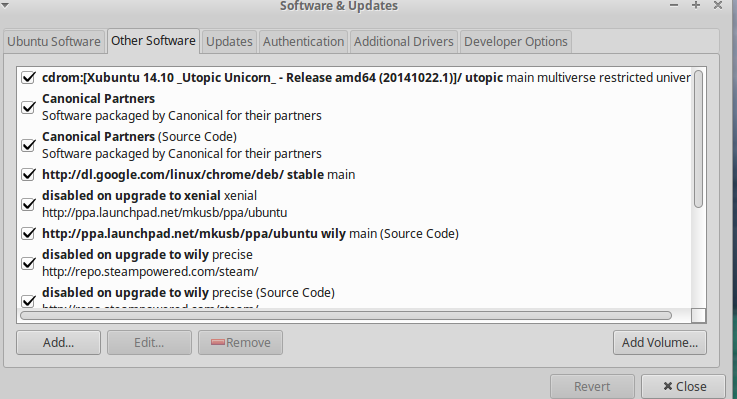

But where am I checking? Xubuntu has "Software Updater" in the applications menu, but that's the same thing as the 'software updates' it sends regularly.
You're checking Canonical's repositories for most stuff.
One complaint sometimes raised against Canonical and Ubuntu is that the repositories aren't at the current revision level for a lot of apps. There's a reason for that. Canonical is trying to play in the same space as Red Hat.
Red Hat makes its living selling support. You can get Red Hat Linux free. (The CentOS distribution is the open source version of Red Hat Enterprise Linux.) But if you decide you need support, there's an RPM you can apply to change the branding of CentOS to RHEL, and you call Red Hat and say "I'm running RHEL, and I'd like a support contract. What are my options?"
Canonical offers Ubuntu in supported versions, so they'll be fussy about stuff in their official repos being stable, debugged versions, because they may have to support it. This means bleeding edge code won't get added. If you need bleeding edge, well, that's what PPAs are for.
You can install other repositories in the list apt uses to look for updates in, and can install packages directly outside of that interface, but for the most part, what the official repos have is adequate.
If you think you're missing out on the latest and greatest, it's on you to find out what the latest and greatest is, and determine whether you need it enough to look farther afield than Ubuntu's repositories.

Originally Posted by DMcCunney View Post
And if they work great as dedicated word processors, that's a valid use. I do wonder how fast they are to boot, and how long LO takes to load, but if all is well once it's up, that's the critical part.
Thanks Dennis. Yeah, they are slow to load but only 2 or 3 minutes. No biggie.
This will be my next learning project.
So that would be adding them to "other software" then, right? (see screenshot)
That's snail slow for most folks. It's one reason I recommend adding RAM.
Yes. That's the list of sources looked in for possible updates.
