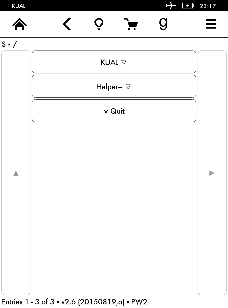

jailbreak was originally developed on a PW2. Worked fine for lots of people. the method of executing it has drastically changed from what I developed, hence, there could be bugs. Run my original instructions if things aren't working (i.e. the menu text never changes)
Oh well, the JailBreak-1.14.N-FW-5.x-hotfix worked for me
