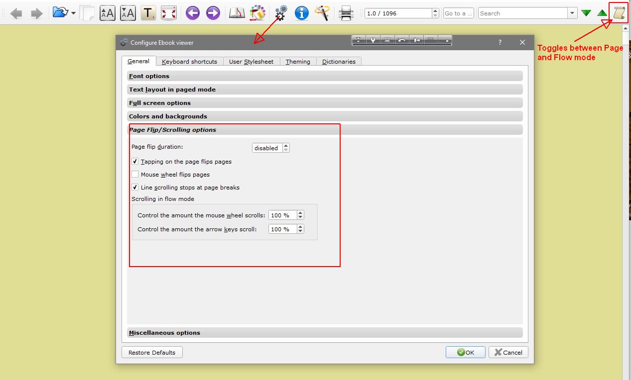

@Andys - have you tried adjusting the Viewer settings, viz
If the settings don't help, then you could try one of the browser based epub readers (e.g. EPUBReader or Readium), if you find one that suits then you should be able integrate into calibre via its Open With feature.
FYI - there is a new version of the Viewer currently under development, consequently the current version is in 'life support mode'.

Just click the yellow scroll icon in the top right corner to switch to flow mode from paged mode.
Thank you, God! It just worked.
Not perfect (as in - scroll X pixels per mouse scroll click is still unavailable), but at least I can see images wholly now.

Mouse wheel scrolling does not flip pages unless you are in paged mode or you have set the option to do so in the viewer preferences under page flip/scrolling options.
