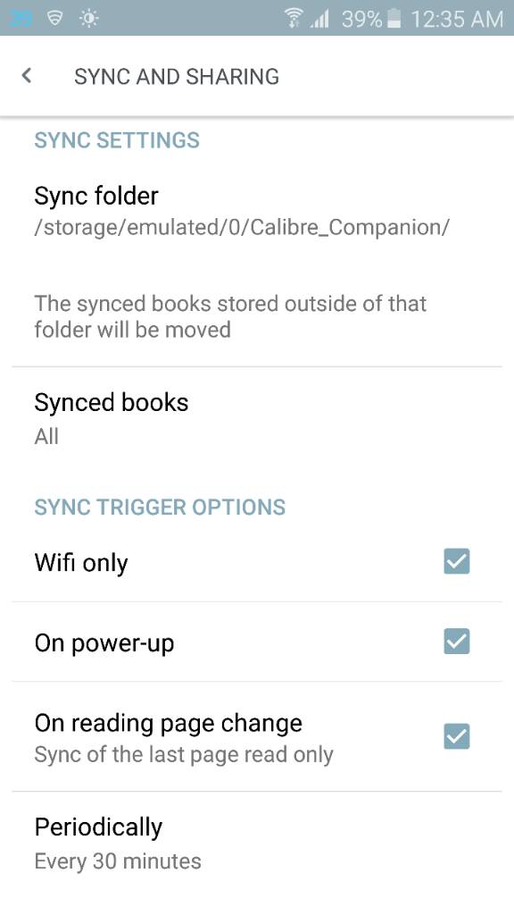

I think I found what deleted my books - Mantano or whatever it's calling itself now. I tried to use the sync and neglected to notice that it will move your books in order to sync for some odd reason. Since sync requires you to have books in one specific folder it's not compatible with CC.
Well, that is cool.
Looking at that screen capture, my guess is that you can tap on the sync folder and change it to whatever you want. I am sure that the default for Mantano isn't "Calibre_Companion". What isn't clear is whether or not sub-folders are allowed.
However, I also suspect that things won't go well if the sync folder is on an SD card when a device runs Android 5 or later. The permissions will get messed up for sure.
Putting these two suppositions together, I suspect that if CC stores books in main memory in a one-level-deep folder, and if Mantano is told to sync from that folder, then things will work "better".
What exactly is Mantano syncing? Is it actually copying books between devices?

It doesn't appear that sub-folders are allowed. I couldn't get book position to sync, so who knows exactly what Mantano syncing is supposed to be. I got crashes and non working buttons just trying to sign up for it, but apparently something "worked" at some point.
