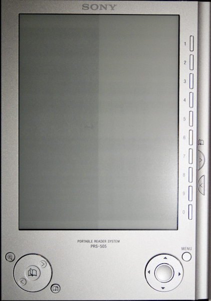

My 2 week old PRS-505 has stopped working. I had connected it to the computer to transfer some files using Calibre. Instead of the screen showing the USB Connected message it very faintly showed an arrow in the middle. The left half of the screen is faintly grey and the right half is white. It's still like that now. I can't get it to switch on. I've tried a soft reset. Nothing changes on the screen. The LED flashes yellow for a while and when I plug it into the PC the LED turns red, but then goes out after about half an hour. When it's connected to the computer I can transfer books and view them from the reader on the PC.
Has anyone any suggestions?

I've tried that now, but the screen still doesn't change. I'm wondering if there's something wrong with the screen as I can access the contents for the reader from Explorer on my computer.

It sounds like it is possible a broken screen or screen controller. If you bought it locally I would recommend bringing it back. Most stores will exchange a defective product within 30 days of purchase.

Oh, well, back to the shop. I got it at Waterstones, so I hope they do have a good returns policy because I won't be happy waiting while they send it back to Sony when it's only 2 weeks old.
Here is a picture of what the screen looks like. I seems like it might be the same problem in: https://www.mobileread.com/forums/showthread.php?t=34811

Just noticed the pic, it does look busted.......Waterstones should exchange it for you.
