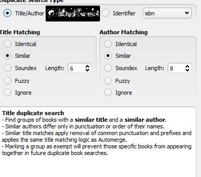

Having said all that, having something similar to the matching rules in the Find Duplicates plug-in (see attachment) would useful for bulk metadata downloads, even better if it could could flag books that didn't get their metadata updated
