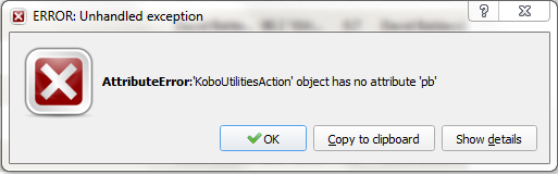

Hi David,
I have a problem with KoboUtilities-beta when I use "Change Reading Status in device library" to mark books as finished, in KoboUtilities it's works okay.
calibre, version 2.40.0
ERROR: Unhandled exception: <b>AttributeError</b>:'KoboUtilitiesAction' object has no attribute 'pb'
calibre 2.40  isfrozen: True is64bit: False
Windows-7-6.1.7601-SP1 Windows ('32bit', 'WindowsPE')
32bit process running on 64bit windows
('Windows', '7', '6.1.7601')
Python 2.7.9
Windows: ('7', '6.1.7601', 'SP1', 'Multiprocessor Free')
Successfully initialized third party plugins: Kobo Utilities && KoboTouchExtended
  File "calibre_plugins.koboutilities.action", line 1315, in change_reading_status
  File "calibre_plugins.koboutilities.action", line 3433, in _update_metadata
AttributeError: 'KoboUtilitiesAction' object has no attribute 'pb'

Old 04-08-2016, 12:05 PM   #1090
davidfor
Posts: 24,905
Karma: 47303828
Location: Sydney, Australia
OK. That's a function I rarely use and apparently I haven't tested for a while. Anyway, your timing is good as I'm in the midst of cleaning up for a release over the weekend. I've fixed it, plus the next error that would have happened.
