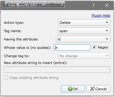

The Toolbag PI treats those as Naked spans (ignores id= part)
Yes indeedy, I can do it there with Click image for larger version
I'd still like it in Modify because a) I could do it in bulk and b) I always run Modify over new epubs to remove the crud like covers and non cd metadata.
To use the Toolbag I have to fire up the editor, click a button and tell the toolbag what to do (every time - hint, hint DD).
But at least now when they do irritate me, which is in the editor, I can get rid of them toot sweet
Thanks for the tip.

So my question is, can Modify be adjusted to remove these unreferenced spans.
The problem with that IDea* is that Modify doesn't build a table of IDs such that it can look and see which ones get referenced and which don't. It's an in-the-moment tool, not a holistic one, and this is one of the shortcomings of that approach. Since removing referenced spans would be A Very Bad Thing for navigation, the only remaining practical option Modify has is to assume that ID attributes are significant and must be preserved.
I run into a similar situation all the time with CSS classes. As a result, sometimes I end up running my "cleanup" script (applying Modify with a certain profile, including strip-spans) multiple times while processing a particularly obnoxious book. It's annoying, but there's really no help for it.

@Rev. Bob thanks for the feedback, I can get by with DD's tool.
