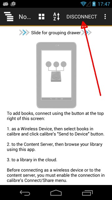

If you initialized CC and deleted all the book files from the tablet then at this point you should see something like the following:
The "Disconnect" menu item should be there (the item pointed at by the red arrow), and (as shown) you should see no books. If you tap the "Device" button in calibre you should see no books.
