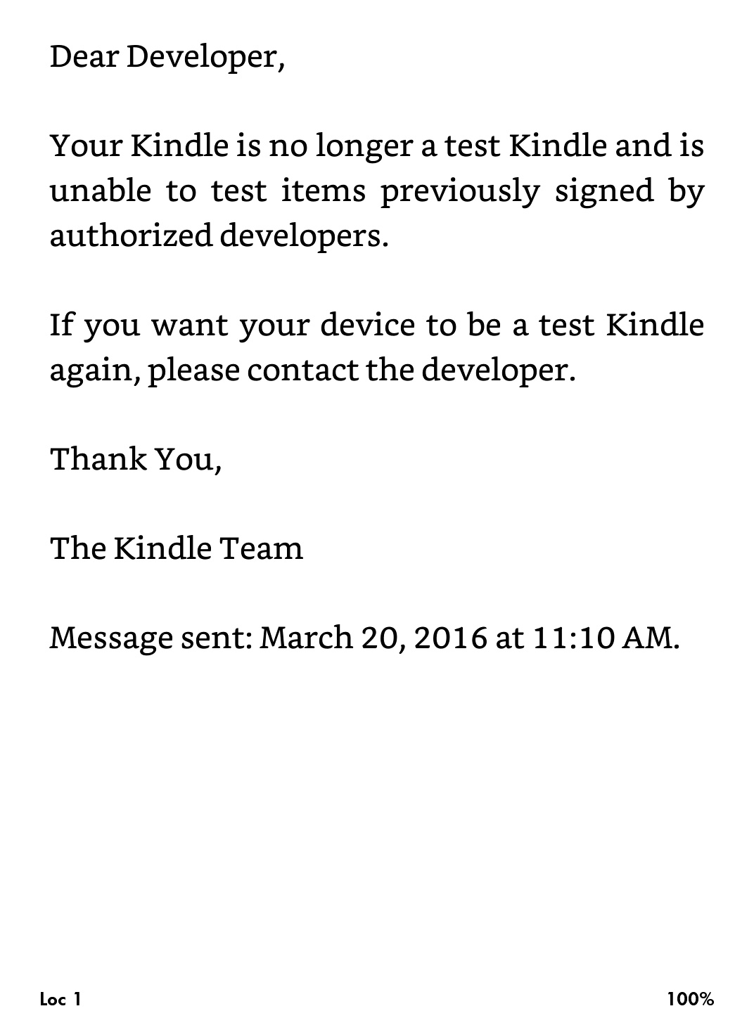

Old 03-20-2016, 01:01 AM   #2238
liyiecho
liyiecho began at the beginning.
Posts: 7
Join Date: Jan 2014
Device: PW2 & PW3
My kpw3 was JB on FW5.6.5. When I deregister my account, and register it again. I got a notice from Amazon.com.Is so easy to lost JB?
Last edited by issybird; 03-20-2016 at 01:17 AM. Reason: Oversize image thumbnailed.
liyiecho is offline   Reply With Quote
Old 03-20-2016, 01:14 AM   #2239
knc1
Going Viral
knc1's Avatar
Posts: 17,212
Karma: 18210809
Location: Central Texas
Device: No K1, PW2, KV, KOA
Entirely normal operation.
You just erased the developer keys (including the MKK keys).
You did not lose the device jailbreak (only the Kindlet jailbreak - which you can re-install).
Note:
You had better trim that image down to size before a moderator can find your GPS coords and nuke you in your sleep.
