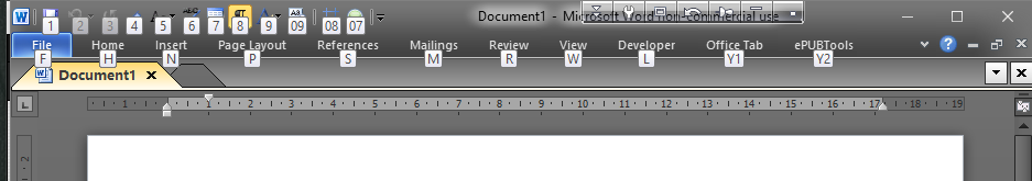

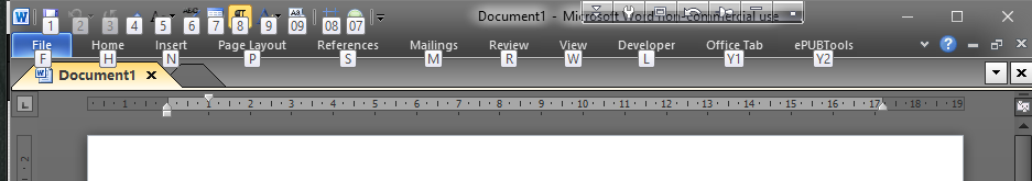

Strictly speaking : Alt+key sequences are not Hotkeys, they are Accelerator keys. Their scope should be limited to accessing the visible controls in the current window. Hotkeys, (keyboard combinations that invoke external processes) should never be Alt+key combinations
If the add-in has access to the full suite of Fluent UI features, perhaps it can leverage what MS and others Fluent programs do - when Alt alone is pressed, display the available 'accelerator key' options as little buttons - here's a couple of examples:
ID:	147225 Click image for larger version
So, to address Toxaris's objection re interaction with external (IMO wrongful) Alt+key HotKeys, the addin would ignore the Alt+R combination, but it would respond to Alt then R by 'clicking' Replace.
Attachment 147225 Attachment 147226
I do not have access to those features. Officially hotkeys/accelerator keys are not possible. I manage to capture the key input in some windows and work with that. That also makes it more difficult to use combination keys like Alt+R. Basically those are more than one keypress and I am doubting if that can be captured.
