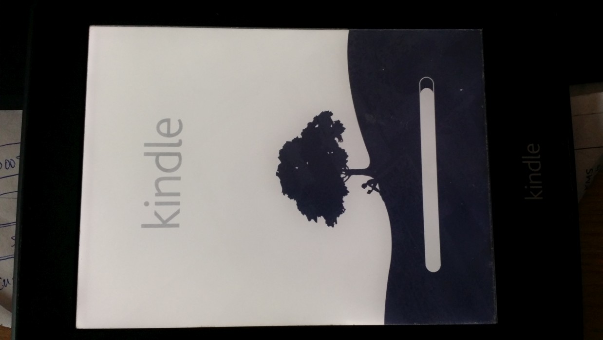

PKW stuck at boot progress bar(95%)
My KPW stuck at boot progress bar (95%).
Reboot, no help.
Connect USB-TTL cable, can update firmware from recovery menu. I tried some versions I can found: 5.3.0, 5.4.4, 5.6.1.1. Update all successful, but still stuck at same place.
Anything I can do to save my KPW?
kenxl is offline   Reply With Quote

here is the boot log:
Reboot, no help.
Which paperwhite?
Give us the first 6 characters of your serial number please.
And you can lookup our nickname for it here:
https://wiki.mobileread.com/wiki/Kindle_Serial_Numbers
What do you mean: "version I found" ??
Why don't you just download the correct (or desired) update package from Amazon?
A worked example:
https://www.mobileread.com/forums/sho...postcount=1301
On your second post -
Use the 'advanced editor' and wrap the output in code tags.
If long, like your second post, wrap with spoiler tags.
OR
Cut&Paste to a text file and make it an attachment to your post.
You will need to find the 'advanced editor' and scroll past the text entry box to the 'manage attachments' section.
Please do not turn this into a game of "20 questions" -
See this post:
https://www.mobileread.com/forums/sho...d.php?t=272087
and read the page that is linked to in that post, please.

Device: Kindle Paperwhite
This is the screen my KPW1 stucks

Not our project, not our problem, ask them for support on their support forum.
Did you notice that with every firmware you tried to install with the Recovery Menu - none of the problem changed?
Translation: You can't fix it with the Recovery Menu.
Did you notice the offset of the kernel u-boot reports as booting?
That is not the kernel being installed using the Recovery Menu and the PW-1, 5.6.1.1 Amazon firmware package.
Translation: You never boot the kernel installed from the Amazon package.
You have three choices -
Restore the Kindle from the 'other' operating system, 'diags'.
Although Doukan has been known to botch that up also, so don't be surprised if that attempt fails.
See:
https://www.mobileread.com/forums/sho...d.php?t=272132
Just use the correct, current, PW-1, 5.6.1.1, firmware posted by Amazon.
OR
Restore the Kindle by assuming only u-boot is working and everything else is trashed (same as if it had been erased).
See:
https://www.mobileread.com/forums/sho...d.php?t=269099
Once again:
Use the correct, current, PW-1, 5.6.1.1, firmware posted by Amazon.
There are many log files attached to the posts of that thread, read them and compare them with the log files you capture as you follow the directions, step-by-step.
You never mentioned what type of computer you have to work with nor what OS it runs.
So I must assume you are certain you can read the directions for whatever PC/OS they are written for and translate them to the PC/OS you are using.
OR
Take it to a local repair shop.
When, if, you get it fixed, install KOreader.
That you can get supported at Mobileread.
If you want support on Doukan, use their support forum:
http://www.miui.com/forum-490-1.html
As you read through their forum, notice just how many things they are using are taken from this site and used without credit to the author or this site they took it from.
That should give you a hint why we don't provide technical support for Doukan here.
Translation:
If the Duokan Project wants to use our stuff without credit where credit is due, they can also use it without our support.
The idea that a free support site, staffed by volunteers, should be expected to support a commercial, for profit, software project is just so wrong that I can't think of words to describe it in public.
