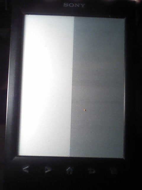

My faithful PRS-T2 finally died during my last vacation. I believe it broke when it fell from about 1 meter up, flat on a solid surface. It is still recognized by the computer and i can transfer files to it (so the touch screen works too), but the display is all garbled and of course is unreadable. I have little hope of being able to fix it - but of course any advice on how to fix that would be welcome.

- you have broken the glass substrate on your Sony. I doubt that repairing it would be a cost-effective thing to try to do.

I was hoping the thing was just unplugged or misplugged... Also, I am not sure what the glass substrate *is*. There doesn't appear to be any crack or anything. The display is just weird.
The substrate is a thin layer of glass on the underside of the screen.
The substrate is an extremely thin pane of glass which forms the back of the e-ink display. The surface is intact, so you don't feel a crack. If you post a photo (check the forum guidelines first) we can confirm, but what you're describing is exactly what a substrate break looks like. The substrate can break with impact, flexion or torsion of the device, or with temperature extremes.

oh, and PS: the sony now shows half the page white and the other half grey/black, vertically. this is after plugging it in and mounting it to get some notes off of it. really odd.

Photo? If all of the lines are perfectly straight and vertical, it could be a screen controller issue rather than a substrate break.

here's what it looks like now.
i really wonder if it wouldn't be possible to just fiddle with the screen connector...
but now i got two new babies on my hands (kobo glo hd and h20 so the sony looks really old and broken.
