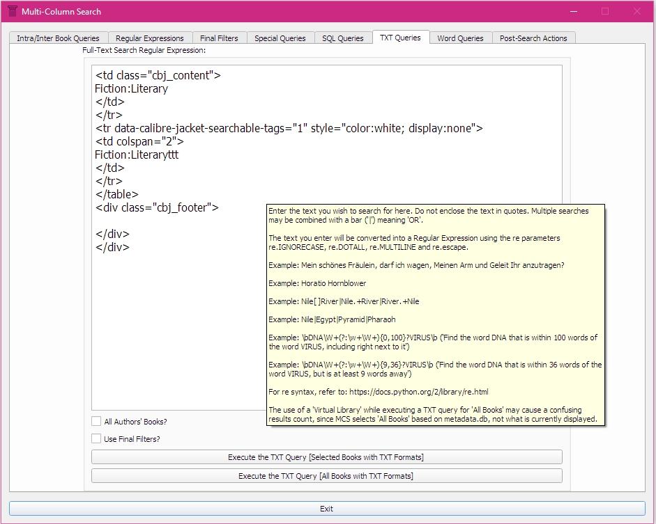

Yeah, no, I don't think it does regex either, which is half the problem. But the thing is, that line? is not a multiline. It's a single line, that is present in the ebook in exactly the form I've written it down. I can't just look for </table>, because I have a lot of books that have multiple tables in them, and I am looking for a specific few ones. Actually, the line I was looking for is far longer, but as regex won't work, the bit I mentioned is basically the only thing I can search without getting too many false positives, so to say. But having nevertheless tried that too, as well as <table>, I can honestly say even that search turns up negative.
Also, that doesn't explain why utterly normal text (well, normal aside from the fact that it is inside a table, come to think of it) will not be found by the plugin either.
There has to be a reason, so if there are reasons, like say, tables are inherently unsearchable or something, I'd like to know for future reference.
edeniz is offline   Reply With Quote
Old 03-12-2016, 07:39 PM   #840
DaltonST
Deviser
DaltonST's Avatar
Posts: 2,265
Karma: 2090983
Join Date: Aug 2013
Location: Texas
@edeniz:
You can use the Multi-Column Search plug-in to do full-text searches (using regular expressions) on selected epubs after converting them to .txt files, but still with the original html tags. Pandoc can do that.
See the attached example which includes the explanatory ToolTips.
DaltonST
