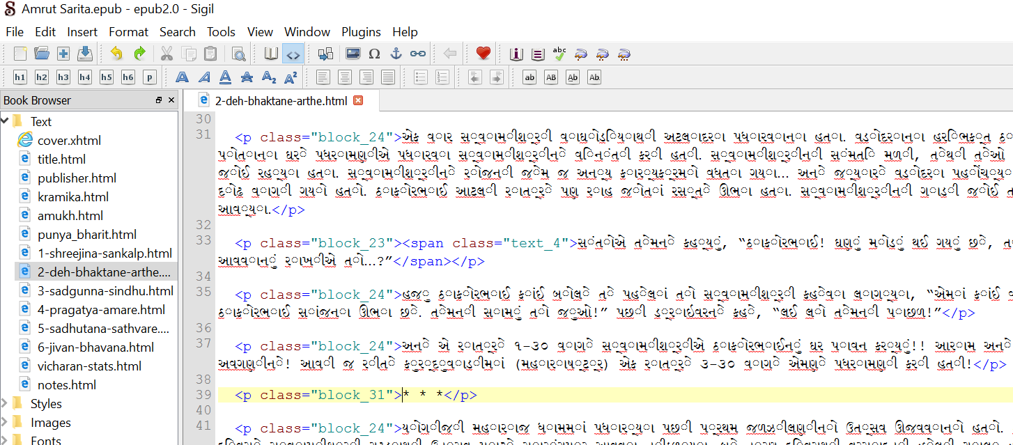

How can I make the Gujarati text in the code editing view appear normal like in the preview? See attached images.
In preview, you can see the Gujarati the way it should show:
In the code view, you can see that the vowel signs that are supposed to combine do not combine:
It makes editing very very difficult.

That is certainly strange. How you tried changing the Sigil Preferences for the font used in Codeview to see if it impacts the situation at all?

@spacesurfer: I wasn't able to reproduce this issue with the 64bit Sigil Windows version no matter which CodeView font I selected.
This is most likely a Windows font mapping issue. Do you have fonts with Gujarati support other than Arial Unicode MS, Nirmala UI or Nirmala UI Semilight installed and/or are you missing Arial Unicode MS?
If so try to temporarily uninstall all fonts with Gujarati support except for Arial Unicode MS to see if this fixes the problem.

I'm using different computers and ALL of them have the same problem. I'm using a Windows 7 32-bit computer at work with Sigil portable 32-bit (downloaded from portableapps.com) because I can't install software on work computers.
I'm using Windows 10 64-bit version (home on one and pro on another) and both have the same problem.
I was using the portable 32-bit version and based on suggestion above I installed 64-bit version and still the same problem.
I don't have any fonts installed except Arial Unicode MS, Shruti (which comes with Windows), Nirmal UI (which comes with Windows), and I installed Noto Sans Gujarati. I removed Noto Sans Gujarati but still no go.
As can be seen in my original images, the software automatically picks up on Arial Unicode MS as the default font for editing in Code View and the Noto Sans Gujarati font that is embedded for the Preview view.
Any more light on this issue is appreciated, especially since Doitsu is not having this issue based on his screenshot... That is what I would like to see... makes a world of difference when it displays correctly.

Based on the glyphs in your first screenshot, I'm pretty sure that Sigil does not pick up Arial Unicode MS as a code view font. If you're using a localized Windows version with an Indic UI language, it might come with additional Indic fonts that get picked up instead of Arial Unicode MS, which is a fallback font that is only used if glyphs aren't found in the main system fonts.
In addition to DiapDealer's suggestion try the following:
1. Download, unpack and open BabelPad.
2. In BabelPad, select Fonts > Single Font and select 48 as the font size.
3. Open a Gujarati epub with Sigil, copy a random paragraph, switch to Code View mode and increase the zoom factor to 200%.
4. Paste the paragraph into BabelPad.
5. Change the font in BabelPad to a font with Gujarati support and compare the text with the Code View text.
6. Repeat step 5, until the BabelPad text is displayed in the same font.
7. Close Sigil and move the font(s) that you've identified in step #5 from the Windows/Fonts folder to a temp folder.
8. Re-open the Gujarati epub with Sigil and check the Code View window.
The first screenshot shows Noto Sans Gujarati font. It shows that because I'm using the font-face property to embed the font and my stylesheets point to that font.
However in the code view, that is 100% Arial Unicode MS. Just like in your screen shot it's Arial Unicode MS. It's not Nirmal UI or Shruti.
