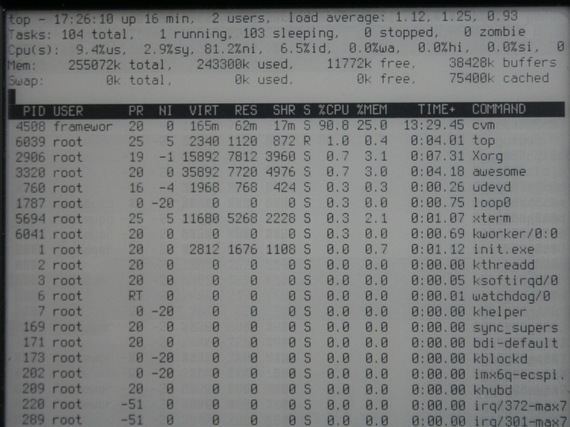

For the moment I cannot run "top" via ssh nor kterm ('xterm': unknown terminal type.) And if i try to run top via screen (locally/xterm), I get "unknown vt100 type".
So, for now the only option is to run top from the old(er) xterm kual extension. Is there any other easy method for screenprints besides my camera?
Oh, and the batterry indicator (bar) is below 50%. Would de-registering / fake-registering help reducing framework/cvm tasks ? I tried that (de-register) after the 5.7.2.1 update and coupled with Airplane mode, seemed to reduce power consumption. But I would use it as a last and temporary resort.
The Kindle understands a "two finger salute" -
Simultaniously touch two diagonal corners == screenprint.
But that was good enough - it showed the same thing I saw on my 5.6.1.1
I just returned from morning errands, for Lunch I'll look at those two config files.
A note on what you can't see (without a serial port connection) - -
With sshd and telnetd 'down' and the USB storage exported over the USB cable - -
cvm isn't even running (it isn't on the process list - only upstart is mentioned as waiting to start cvm). . . .
AND
everything about the 'top' display looks like an idle device (I.E: as expected).
So if the problem is in something that cvm is running -
that means somewhere in the closed source (Java) part of the system.

^ ^ ^ ^ But 'user induced' would not account for cvm sucking up 98% of cpu while the system is supposedly idle ^ ^ ^ ^
[root@kindle upstart]# /usr/bin/dump-stack `pidof cvm`
system: I dump-stack:dumpstack:cvm:pid=20321:begin native threads ==============================
Error while reading shared library symbols:
Dwarf Error: wrong version in compilation unit header (is 4, should be 2) [in module /lib/libpthread.so.0]
Dwarf Error: wrong version in compilation unit header (is 4, should be 2) [in module /lib/libgcc_s.so.1]
warning: Lowest section in /usr/lib/libicudata.so.50 is .gnu.hash at 000000b4
Dwarf Error: wrong version in compilation unit header (is 4, should be 2) [in module /usr/lib/lua/libluasqlite3.]
system: I dump-stack:dumpstack:cvm:pid=20321:end native threads ================================
system: I dump-stack:dumpstack:cvm:pid=20321:begin proc maps ================================
system: I dump-stack:dumpstack:cvm:pid=20321:end proc maps    ================================
system: I tinyrot:def::Rotating file /var/log/messages with max size 256
/usr/sbin/tinyrot : Signaling syslog
system: I tinyrot:def::Rotating file /var/log/netlog with max size 256
system: I tinyrot:def::No file to rotate: /var/log/netlog
system: I tinyrot:def::Rotating file /var/log/odotlite with max size 2048
system: I tinyrot:def::No file to rotate: /var/log/odotlite
system: I tinyrot:def::Rotating file /var/log/wpa_supplicant with max size 128
system: I tinyrot:def::No file to rotate: /var/log/wpa_supplicant
system: I tinyrot:def::Rotating file /var/log/metrics_generic with max size 64
system: I tinyrot:def::No file to rotate: /var/log/metrics_generic
system: I tinyrot:def::Rotating file /var/log/metrics_high_priority with max size 64
system: I loginfo:devhw:boardID=0670:muscat device - rev 2
system: I loginfo:devsworig::Original System Software Version: 033-juno_6011_muscat_wario-263413
Wed Apr 15 08:15:02 PDT 2015
com.lab126.eink.muscat.os
system: I loginfo:devswota::OTA  Kindle 5.6.1.1 (~~otaVersion~~)
com.lab126.wan failed to access property localTimeOffset (0x3 lipcErrNoSuchSource)
system: W loginfo:ltofailwandoff:cannot retrieve local time offset - wand not running
Mis-matched cvm build and system library build.
Someone use the above dumpstack command to see if 5.7.x (or whatever your running) is any better.
those are back-ticks, not single quotes in the command.
next question?

Here is my dumpstack:
[root@kindle vasi]#  /usr/bin/dump-stack `pidof cvm`
system: I dump-stack:dumpstack:cvm:pid=4508:begin native threads ==============================
Dwarf Error: wrong version in compilation unit header (is 4, should be 2) [in module /usr/lib/libdevice-cap.so]
system: I dump-stack:dumpstack:cvm:pid=4508:end native threads ================================
system: I dump-stack:dumpstack:cvm:pid=4508:begin proc maps ================================
system: I dump-stack:dumpstack:cvm:pid=4508:end proc maps    ================================
system: I tinyrot:def::Max file size hit 2 on /var/local/log/metrics_generic_00000048_20160310143004.gz
system: I loginfo:devhw:boardID=0620:bourbon device - rev 6
system: I loginfo:devsworig::Original System Software Version: 015-<private>-289939
Fri Feb 26 01:55:39 PST 2016
system: I loginfo:devswota::OTA  Kindle 5.7.3 (~~otaVersion~~)
SlashMaster is offline   Reply With Quote

Since my posting, it has occured to me that perhaps that dumpstack utility is the only thing that got mis-built (and its output is meaningless).
I have also been digging around in /etc/upstart and reading the scripts.
There are quite a few debugging related things mentioned - I wish I knew which one would provide the answer.
You can enter the following command without any options and it will report on what options it accepts.
But cvm continues to hog the cpu (and the SoC still is drawing almost the max. current it can) -
Which means one of these services is broke:

@knc1: Which thread is hogging the cpu? (htop has a thread view if the bundled busybox ps sucks).
I'm also not sure CPU_IDLE is applicable on ARM/the freescale Kernel. I think the equivalent for mxc chips is properly handled somewhere else.

I can see no problem with the display of CPU%, either the total summary or the indiviual listings.
It follows the battery current draw from -168ma (98.8%) to -2ma (less than 0.0%).
Which is reasonable and about the only thing that is reasonable about this problem.
But I will try to get 'per cvm thread' numbers also.
For the non-hardware guru readers:
The SoC is built with CMOS logic.
A characteristic of CMOS logic is that the current draw increases with (both) the frequency the logic devices switch states and the number of logic devices switching states.
Plus -
The problem is that the device is using too much battery power.
The comments about cpu load are just side-effects of whatever the real problem is.
And a real far out comment:
Keep in mind the SoC is no longer "Freescale" but "NXD" -
The new company owners may have let a manufacturing error slip into the process of building the i.MX6 devices.
The few people reporting problems may just have Kindles built with the floor sweepings of the chip foundry (higher chip construction error rates == lowered production costs).
