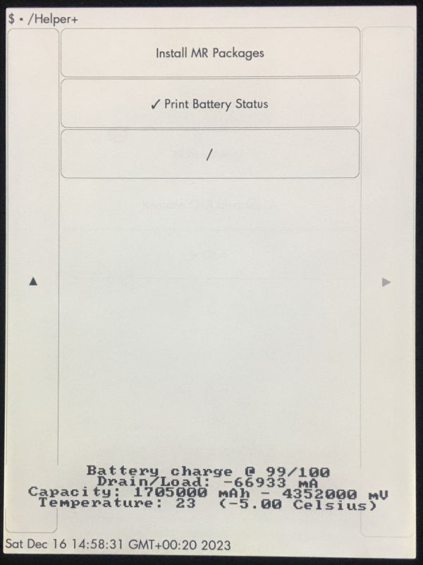

Old 12-16-2023, 10:26 AM   #42
sarigabor
sarigabor began at the beginning.
sarigabor's Avatar
Posts: 37
Karma: 30
Join Date: Mar 2019
Location: Hungary
Device: Kindle PW (12th gen 2024)
Kindle PW5 - tested, working good
Tested on a K2/3/4/Touch/PW/PW2 .
Today, tested on PW5 (5.16.2.11)
Name:	2023.12.16 PW5 5.16.2.1.1-3.jpg
sarigabor is offline   Reply With Quote
