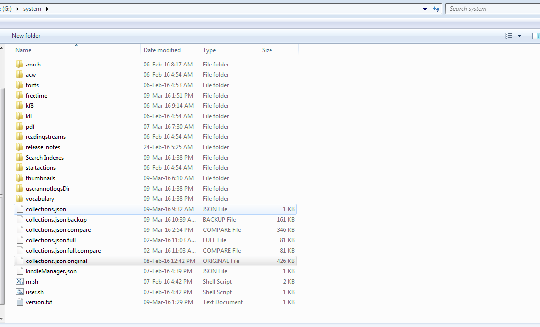

I followed your suggestion and i started looking for .json collection file in kindle.I could fine few files in the systems folder hidden in kindle drive of windows 7. There i found 7 json file only one ending with .json. I have attached an image of it.
I do not know which one should i delete, if at all, to start creating fresh collections. Am I in the right folder to delete the json file?? I was wondering if deleting these .json files from system hidden folder would not harm my device in any way or prevent it from starting up.
And i am following the backdoor thread and 5.6.5 jailbreak release thread, very closely, for blocking updates. Currently,I have 185 mb free space and i have only created update.bin.partial folder in the root directory. It seems to have taken care of stopping the update for me even when the space was 500mb. That is what the sole thing i have done and checked to keep away silent updates from kindle.
Please take a look at the attachment and guide me which file i may have to delete to start collections working again.
Thank you knc1.

Originally Posted by mitra View Post
So which collection file should i delete sir without causing any harm to my device?
All of them -
They are only used by LibrarianSync when it builds the Kindle's (hidden) database.
Let the Calibre plug-in generate a new, correct, one.
**OR**
Put your books in a directory tree under documents where each sub-directory name represents a collection name.
Then let LS rebuild the Kindle's database from the directory tree structure.
Note:
This second way has the advantage that both the Kindle's native collections and what is shown in KOreader's file manager will be the same layout.

The second option is better.
Just to be sure, collections.json, .backup, .compare, .full, .original and kindleManager.json----all these 7 files should i delete it?
mitra is offline   Reply With Quote
