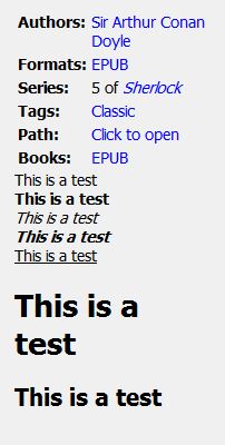

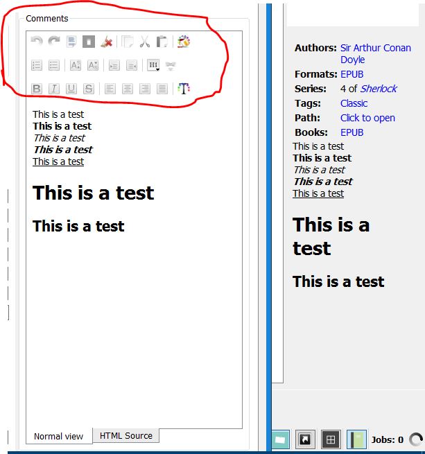

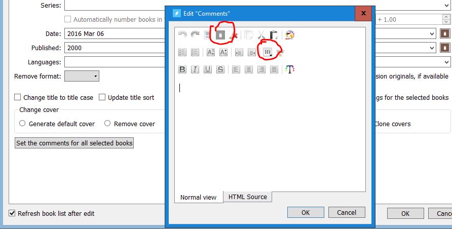

As a little test I added some formatting to a number of books (first screen shot) and tried bulk edit [Set the Comments...] (screen shot 2) and selected remove formatting and normal (hoping it would just delete the <hx> tags and the bolding and italicing, leaving the basic text
But that did as I suspected it would and cleared the metadata comments text also.
Is there an option I'm missing or is there a work around to just clear the formats in bulk, or is it a one book at a time operation?

Not in Bulk mode, but in Single mode, yes.
You need to select the Text to affect (in Comments: Normal View) and use the recycle icon
That cleans just that

1. Select all text
2. Remove formatting (to remove bold and italic)
3. Apply Normal (to remove h-tags)
